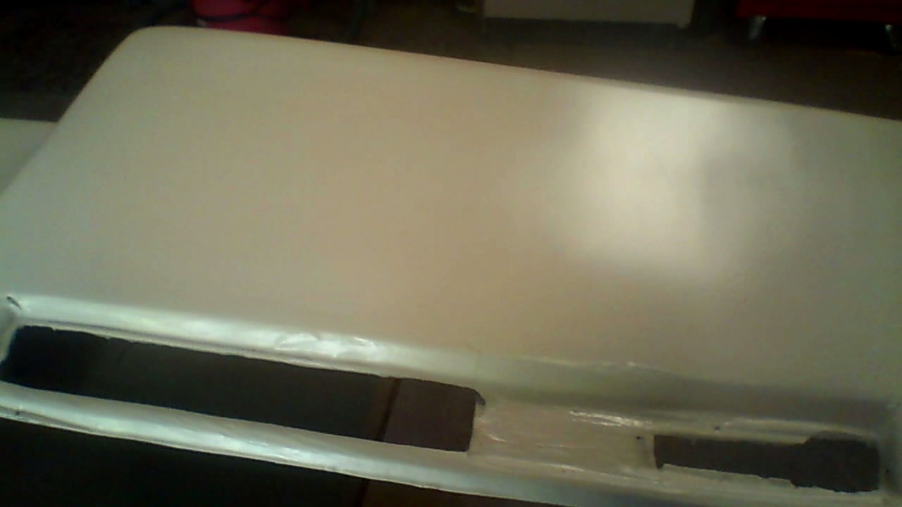

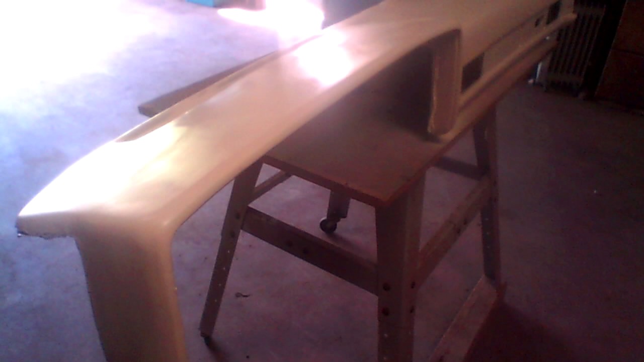

Here is an option. Fiberglass resin on the cracks, sand it then paint. This is the dash out of a 85 going into a 76 along with the bezel.
How did you address the fact that the vinyl curves up where ever it cracks? Did you just sand that off?

Took a razor blade and cut the vinyl back a little from the crack. Yes it leaves a wider spot there from the crack, apply the resin a bit thick in that area. The crack that is on the pass. side between defrost slot and pass. end of the dash is the hardest, may have to work it a couple of times.

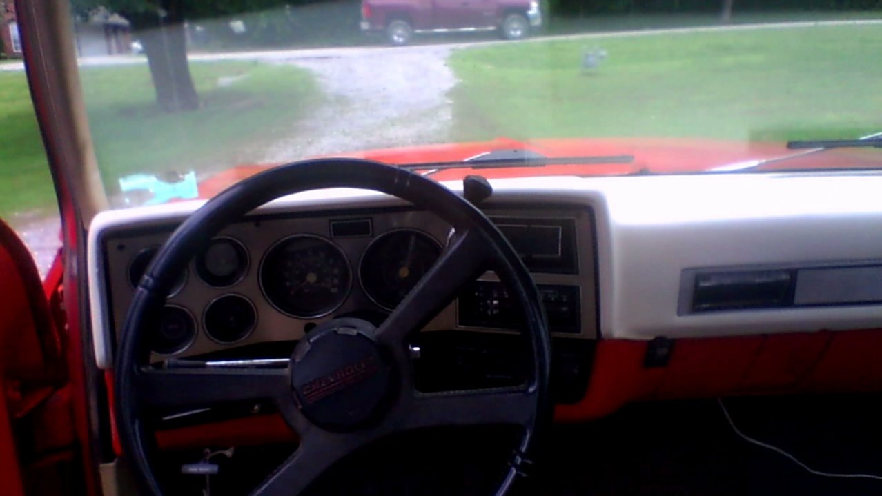

You need to make a tutorial. I want to take mine and redo it and dye it blue.

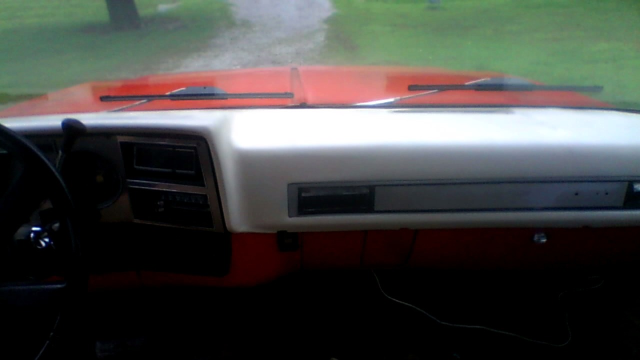

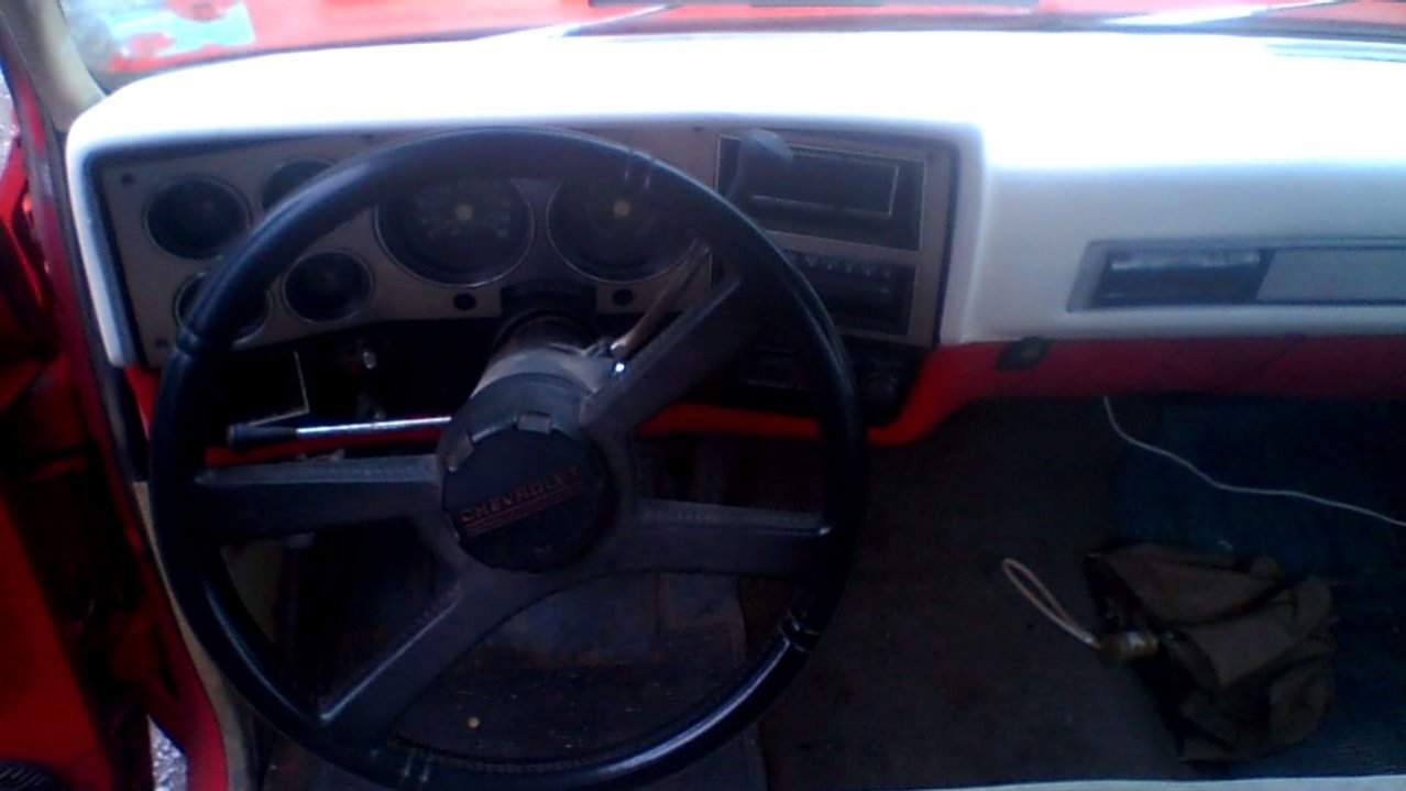

Dupla color is what i painted it with.
