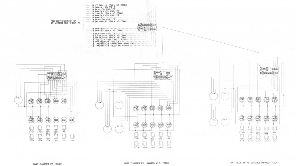

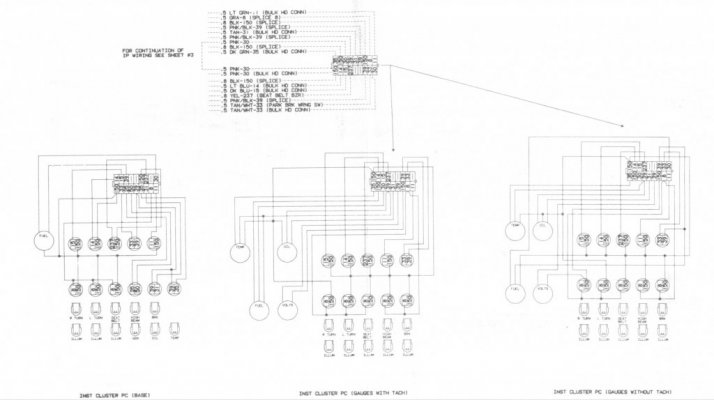

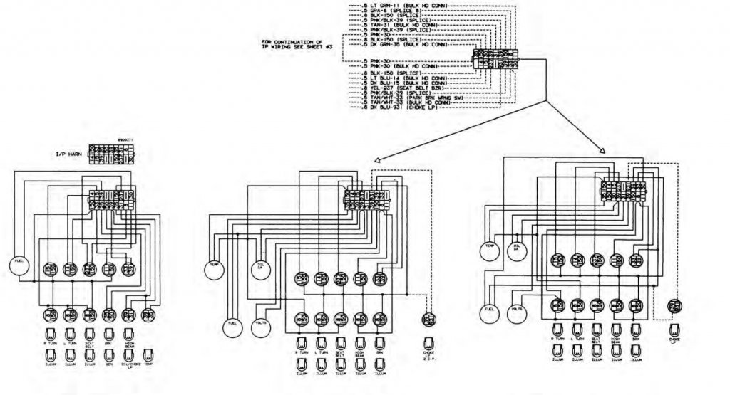

Jun 27, 2023 #5 PrairieDrifter Full Access Member Joined Dec 28, 2014 Posts 3,474 Reaction score 4,601 Location North Dakota First Name Mason Truck Year 84,79,77,70,48 Truck Model Suburban k10, bonanza k10, c30 C&C, c10, gmc 1/2ton Engine Size 350, 350, 350, 350, 350 84 and 85 were transitional years. I would expect some differences.

Jun 27, 2023 #7 Jgonick Full Access Member Joined Jan 12, 2017 Posts 198 Reaction score 263 Location West Texas First Name Joel Truck Year 1985 Truck Model K10 Engine Size 350 wiring schematics of 85 & 84 DK BLU-931 Choke LP addition to 85 is the only difference I could see. Attachments 85.jpg 100.7 KB · Views: 47 84.jpg 66 KB · Views: 45 Last edited: Jun 27, 2023
