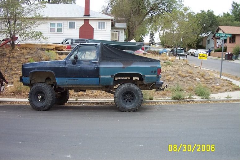

I done the conversion with dual wheel hubs on my blazer
I beat the **** out of it off road with 38'' tsl swampers and a arb front locker
and daily drove it on the street the axles lives on but the blazer got parted out
it narrows up the front a little but I ran 16.5 wheels with no issues
