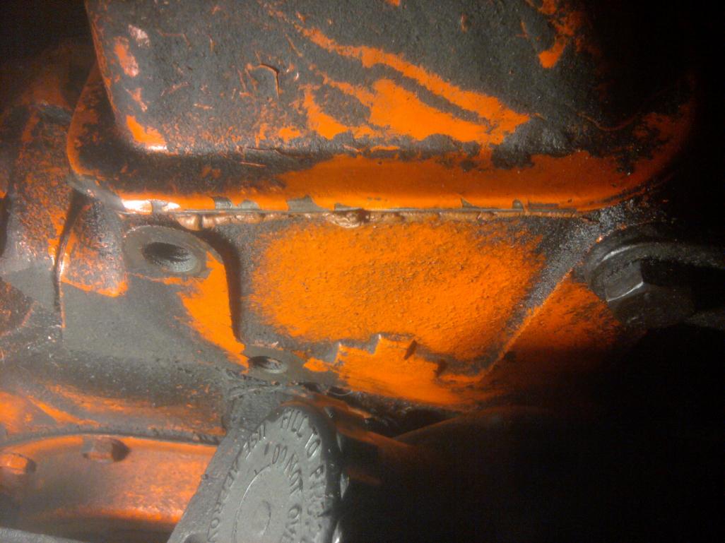

Exactly what I was thinking...Can you see an marksmon the front of the heads, maybe get us a pic?
Most of those heads were the same smog headsnup to 86, which arenthe same heads that GMPP is using on the 290/350. they havenkinda a lopsided trianglemcast on the front of the heads for Identification.

The front of the head has this shape. The shape is also cast under the valve cover.
