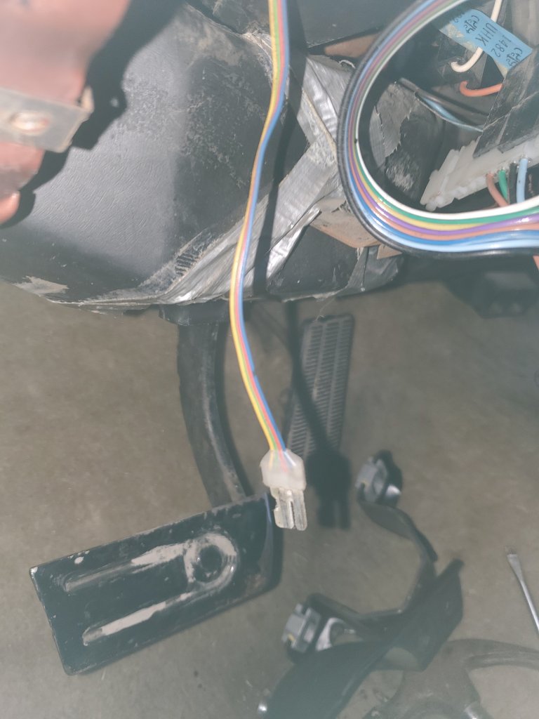

1982 suburban, I just installed a new turn signal switch and tightened up the tilt bolts but the small cruise wire doesn't seem to have a buddy to connect to. Does anyone know where this goes?

White plastic plug at the bottom of the column, IIRC.
Should be easy to ID since it only has 2 wires.
Where did you find a non resume style switch?
I would not mind having a spare.

It came with it, I just assumed it was factory but too many have messed with it to know for sure. So it's a white 2 wire plug? Do you happen to know the wire colors? Thanks!

I found it I found it lol. It was at the end of the thin stamped steel bracket that bolts to the bottom of the steering column. I thought I was going crazy
I have been looking since last night for a pic of that thing on the web - nada.
What color was the female plug ?

You were right it was white and at the bottom of the column i just didnt look far back enough. I didnt pay attention to the 2 wire colors because I was so excited I found it hahaha. If you look at the connector it doesnt even look correct as the flat male connector goes sideways into it and locks in. The bonus is I just drove the sub and the cruise works!! Of course all that work wasnt without its problems, now the horn doesnt work, OMG. I love how tight the steering is now and the new signal harness is nice and tight I just wish it wasnt such a bear to do. After all said and done it took me almost 7 hours and I took the column apart no less than 8 times trying to figure out the proper bearing sequence. Its seared into my memory now so if anyone needs help here I am
