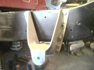

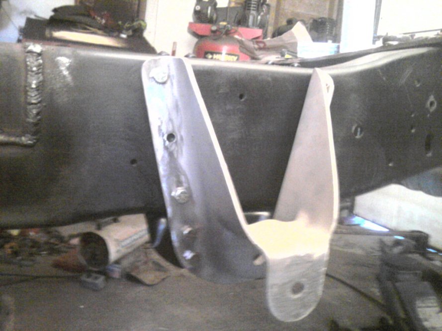

read threw my crew cab build thread I shortened the frame to a short bed and swapped the spring hangers so I could use a 3/4 ton axle
the spring hanger swap is pretty easy and makes it so a 3/4 or 1/2 ton axle will bolt up
I think that would be better than putting two different frames together
there is a link to my build thread at the bottom of my posts

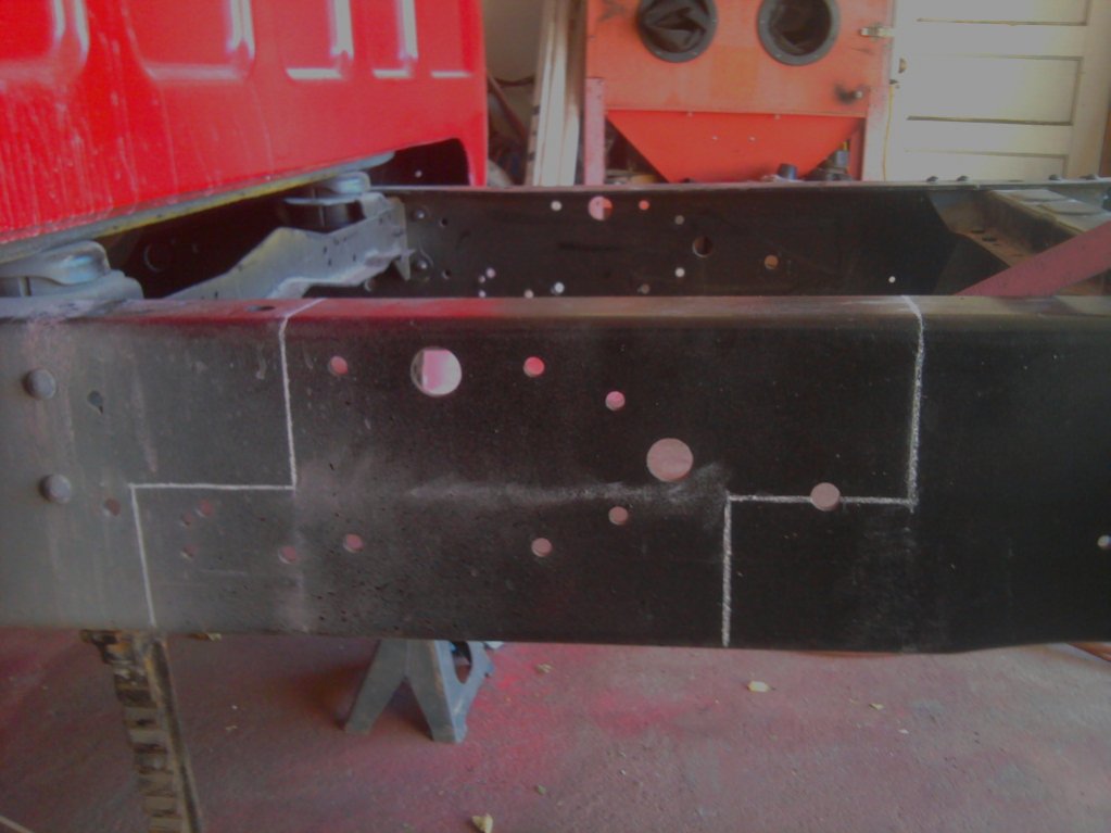

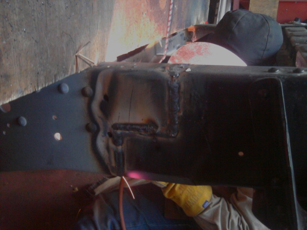

Well, decided to do the frame graft. Went very smooth, total swap time approx 4hrs.

lol, yes, went much easier than anticipated. Measure twice, cut once. I tried to have everything ready. TIG'd the joint, root, filler and cap in ER70S, went very nice. Fishplate rear plate and boxing interior of frame with MIG. The time includes swapping fuel tanks, and fuel and brake plumbing, but not driveshaft. BTW, I had 3 buddies helping (drinking beer). Don't know if that helped or hurt the timeframe though.

I think most guys just cut out a section and then push the same frame together, and just swap boxes.
