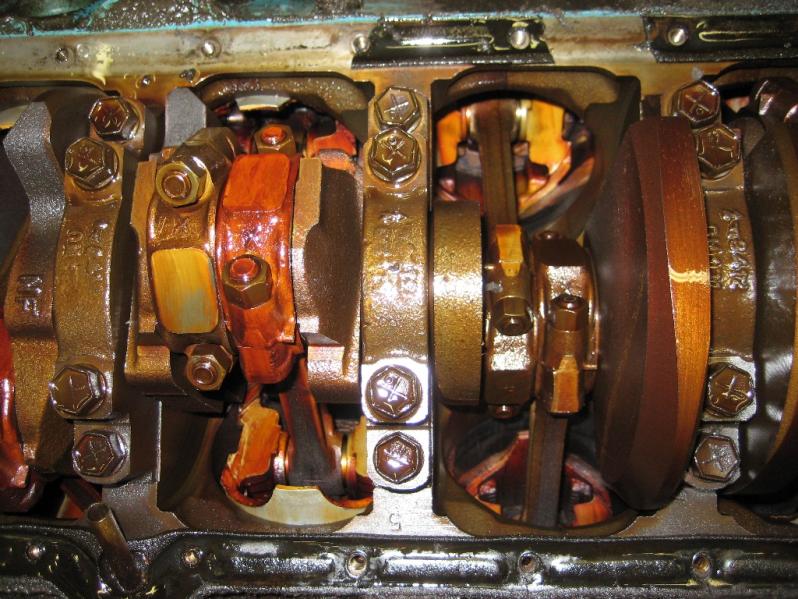

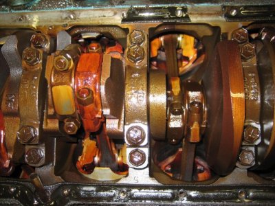

Does this mean Ive got a 4-bolt main engine? block casting # is 39GM - 14016379
got the heads off tonight. and is orange varnish normal?
As I took off the long head bolts, the #5 cylinder intake bolt was milky brown - so I assumed a blown head gasket at that location, but once I got hte heads off, the metal gasket seemed to be fine. How do you look for evidence of a blown gasket when its metal?
If you ask me, that #5 rod looks to be twisted on the crank journal too. Or is it the angle of the pic???
Edit, I guess that would be #3 looks twisted. The first one on the left in the pic. Angle of the pic maybe... :shrug:
