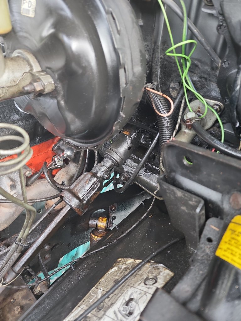

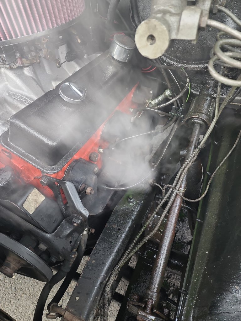

Didn't notice it but I'll have to double check. Checked the valve cover gasket and it's not from there, but there was metal flakes mixed with oil sludge underneath. It appears to be coming from the driver back side of the motor and going down the exhaust pipe and blowing up onto my booster, master, and firewall. 90% sure it's head gasket. Hoping it's not worse.
Where is it leaking from? If it was actually 280 that isn't good. Like others suggested the sensor probably wasn't tight. The shop that did the work will have some liability on this. At this point stop doing anything, take it back.
I did he, and kept it a week. Mechanic said it needed a new temp sensor (reading improperly) and tachometer but it was drivable. At this point he's hiding behind a no labor warranty and will not do anything about it.

At this point start thinking the motor may be damaged and what the options are. A new motor especially can be quickly damaged without coolant. It will have higher ring drag during break in. Already sounds like your mechanic has denied responsibility.

Scratch that mechanic off of your list. Get an inspection mirror and also check the freeze plug on the back of the head.
