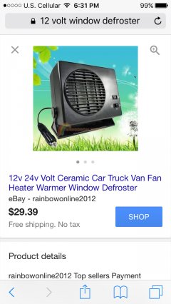

Why not something like this mounted so it blows on the back windows. Less trouble than messing around with coolant....

Electric does sound like a way to go. I did not think about the radiator cap, but it is possible to mount heater core on the floor part of AC cover and use blower fan

I was thinking of factory heater set up at the floor level blowing through the AC cover ducting to the top. But electric would be easier and faster to set up regardless. Plus, the AC blower wires and control switch can be used to turn it on.

Provided they will handle the amperage. That 250 watt heater will pull over 20 amps at 12 VDC.

Relay, but then you still have to run another set of power lines back there.
And that is still easier than coolant hoses.

The factory blower wire is right around 12awg.
