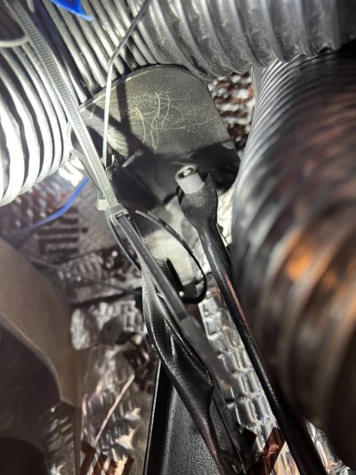

No, it’s not the main fuse block. You can see part of the bracket and the relays and hazard flasher in the picture. I read they call it a convenience center. It’s tied into the wiring harness

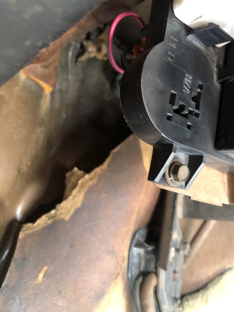

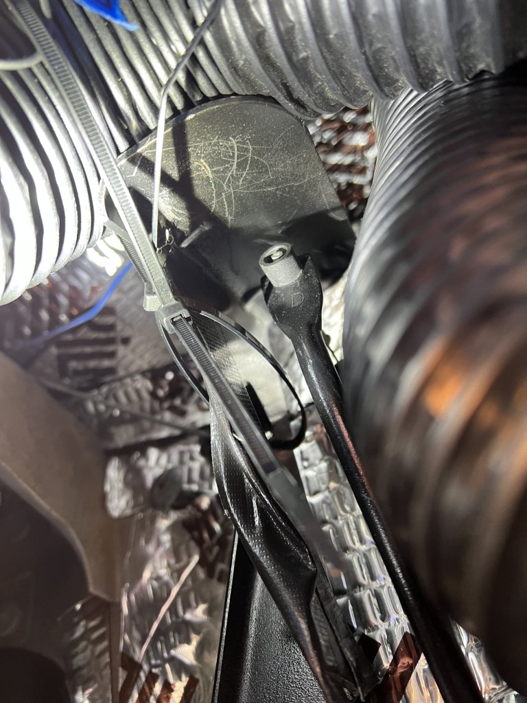

C-10 LWB
our C10 had same thing but nothing attached to it, part of the brace for gas pedal. We cut it off to give us more room to work with the wiring and vintage air ducting

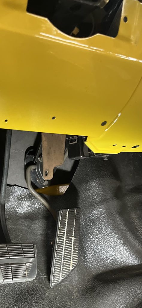

Chevy K-10 Custom Deluxe
I don’t have the convenience center but do have the bracket, I used it to mount all of my aftermarket electronics modules. Here’s the bed picture I could find

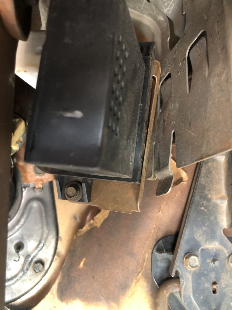

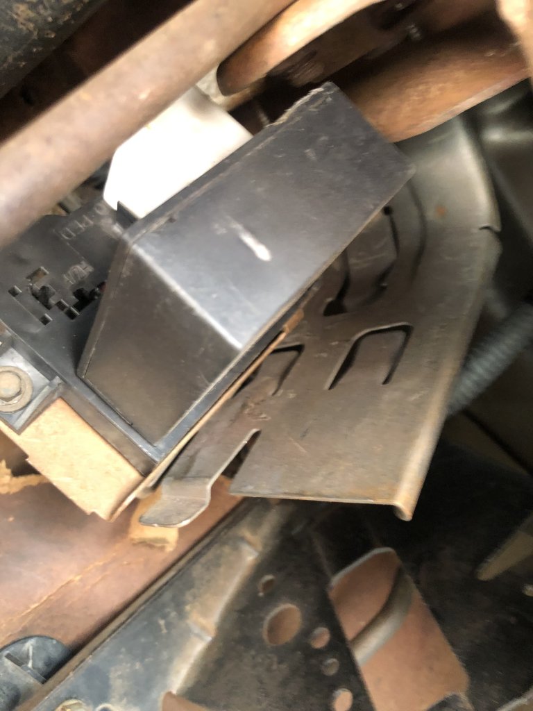

These are the best pics I could take with the limited time I had.
The cruise control module clipped to the bracket above the gas pedal, the convenience center bolts above and to the right of the pedal. Unfortunately, with the brake controller in the way I couldn’t get a decent pic of how it mounted.
Hope that helps

hi, i recently have reworked my interior and it is correct that it is called the "convenience center" and it is mounted on a bracket that is located above & right of the factory gas pedal the above pics (matt69olds). I am not sure how it was "removed"? as mentioned, it is tied directly to the factory interior harness/fuse block. In my rebuild I looked at trying to remove it, but due to it's harness intagration I decided to just leave well enough alone. it is described in the wiring diagrams for the year model of truck - in my case a 1986 C10 2wd 1/2 ton.
good luck & keep us posted! .. ;)
