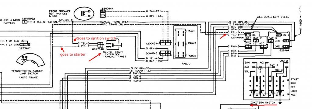

You are dealing with a manual correct? Manual transmission- Usually a yellow wire goes from ignition switch to clutch switch then purple wire goes to starter.
On a 86 automatic, it will be a purple wire from ignition switch that goes to starter.-(the automatic's manual safety switch is mechanical in the steering column)
See attachment.

Yes it’s a manual and the problem I’m having is there is a second place for a plug and I don’t know what wires run to the second plug. Then I had a thought, could the extra plug be there for a cruise turn off.
