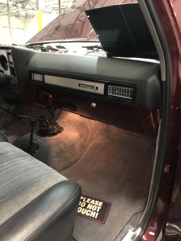

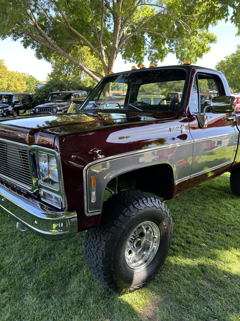

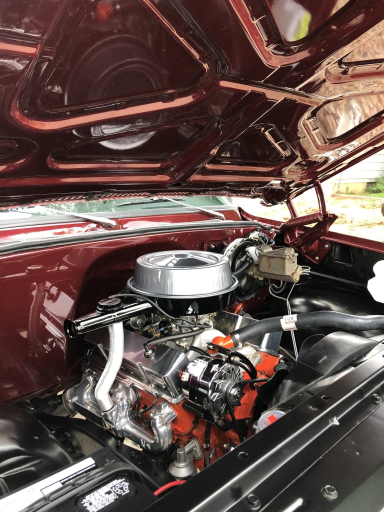

How good are the cab mount bushings? Have actually seen the bushings be so worn the cab moved front to back instead of releasing the clutch.
Cab bushings are all new. This was pretty much a total frame off restoration although some older parts were reused, such as the clutch and brake pedal box and linkage.
