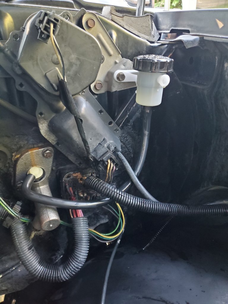

So for anyone who stumbles on this thread later, apparently it was actually the slave giving up. Not sure how that happens, but the slave finally popped the seal and puked fluid out.
And for anyone wondering about the clutch fluid reservoir/gasket, the reservoir from a 99-02 Camaro bolts right on, the hose fits, and you can even use the old cap of you want. Found on Amazon for $13, gasket included.
