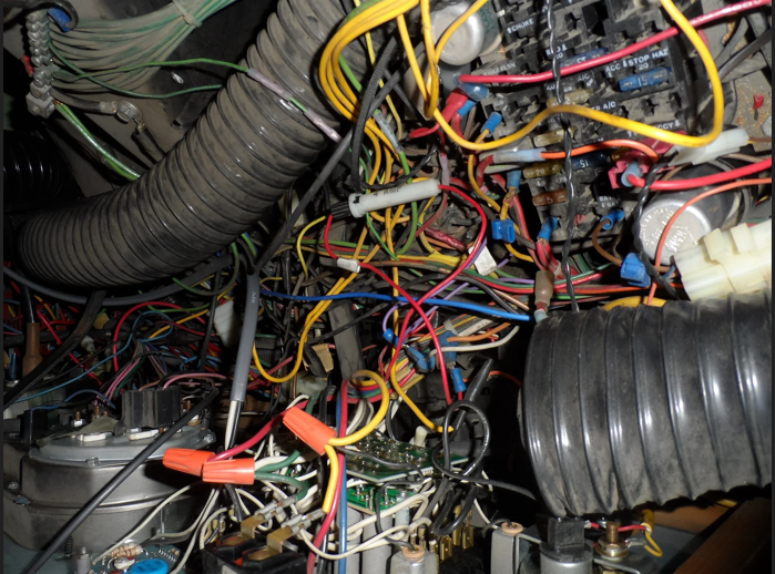

Hey all. I have a 1975 gmc k25 that I have been working on for a few now.
I’m working on the wiring under my dash to the fuse panel. Half of my things work and some work on their time and she kept blowing fuses. Well u took the dash off and noticed so many wires and loose connections that I have lost myself in the ordeal. Can some guide me to any site that would dumb it down with sections at a time to help me get it figured out? Yes the plan is to eventually by all new wires and upgrade my fuse panels. However I just did other work to her and just need her to run for a sparingly moment. Anything helps. Thanks

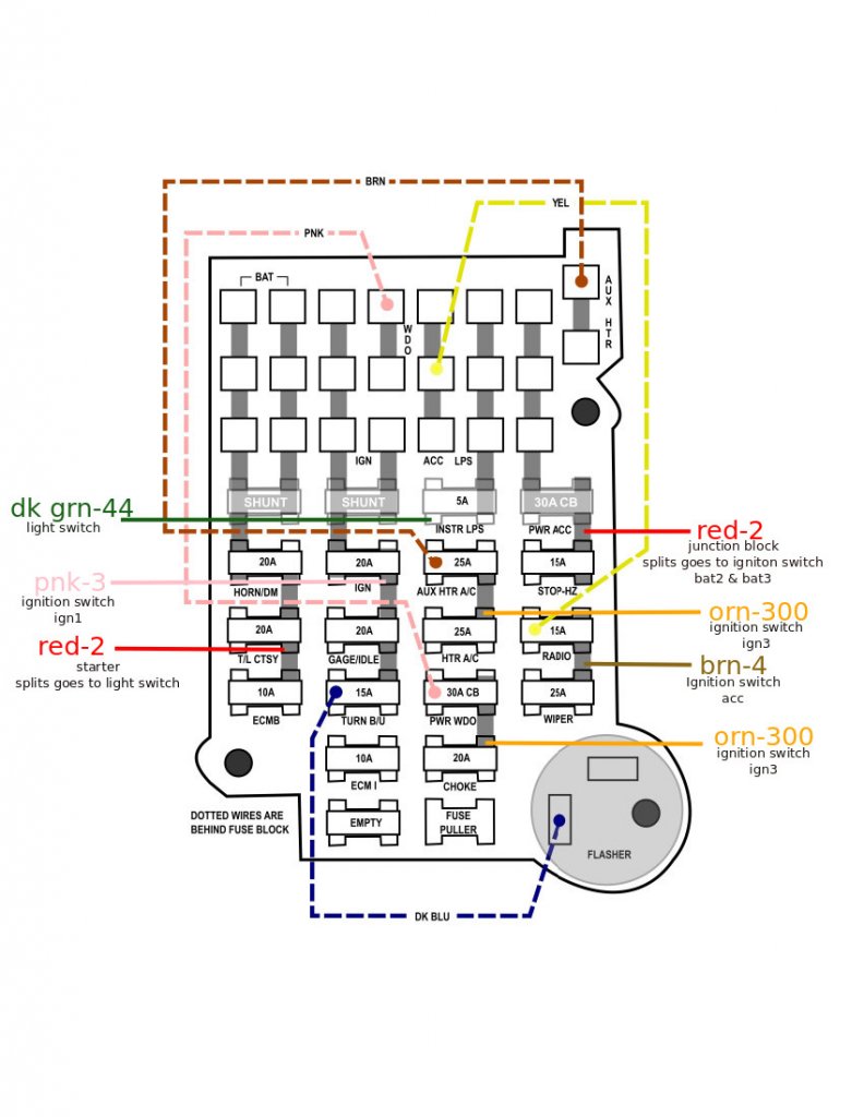

That's a tough situation. The best bet is to get a wiring schematic for the truck and start getting familiar with the factory setup. You will need to know the core wiring to figure out if someone added stuff over the years. The folks on this site are always willing to help if you put up pictures of some confusing parts.This video helped me when i was first starting to identify what goes where. I hope this helps.

Here is the way I did mine:

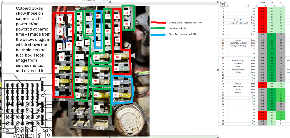

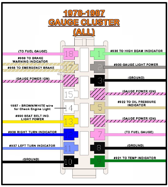

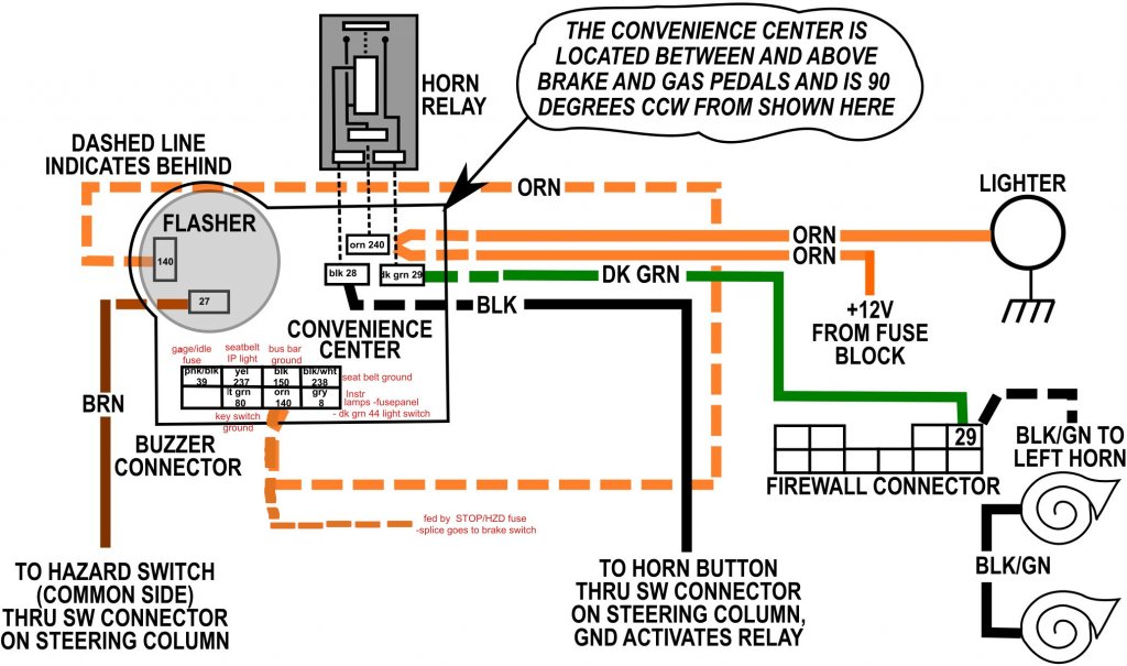

These may help you start your di-ag. (Yes, I stole these like a thief in the night). A good test light and multimeter are essential. Sounds like you probably need to start from scratch. Also don’t forget to check power from the battery to the starters and to the alternator and finally from the starter to the fuse panel first since that is where power for the whole truck starts from. A lot of people chase gremlins because someone got creative powering the fuse panel “a better way.” Once you are 100% under the hood, then start under the dash.
