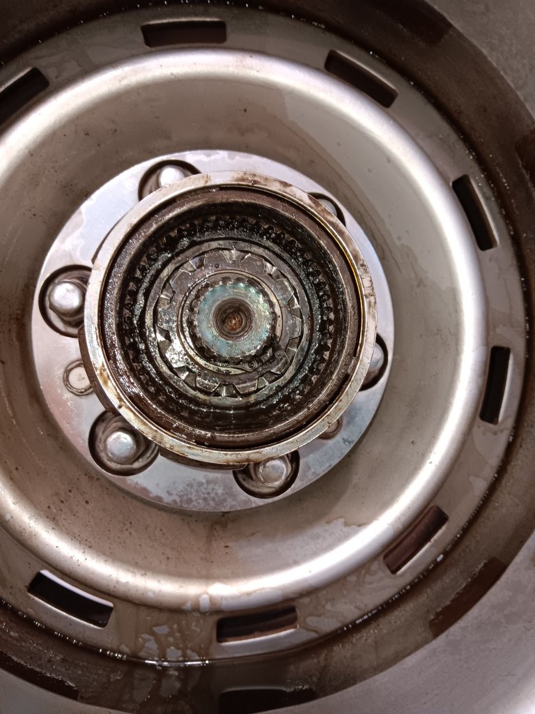

So I never had a problem, but now when I put it in 4x4 mode, I get a click click click front the front end. Front left I think.
78 K5
8 lug
14 bolt 10 bolt 410.
Ideas? Where to start?

Auto hubs, or manual?

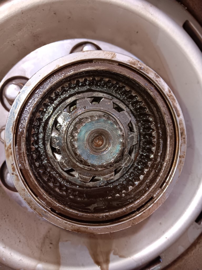

Take the locking hub outer off -6 hex bolts on mine - and make sure the sliding gear isn't hung up. Had to spray mine down last December.
