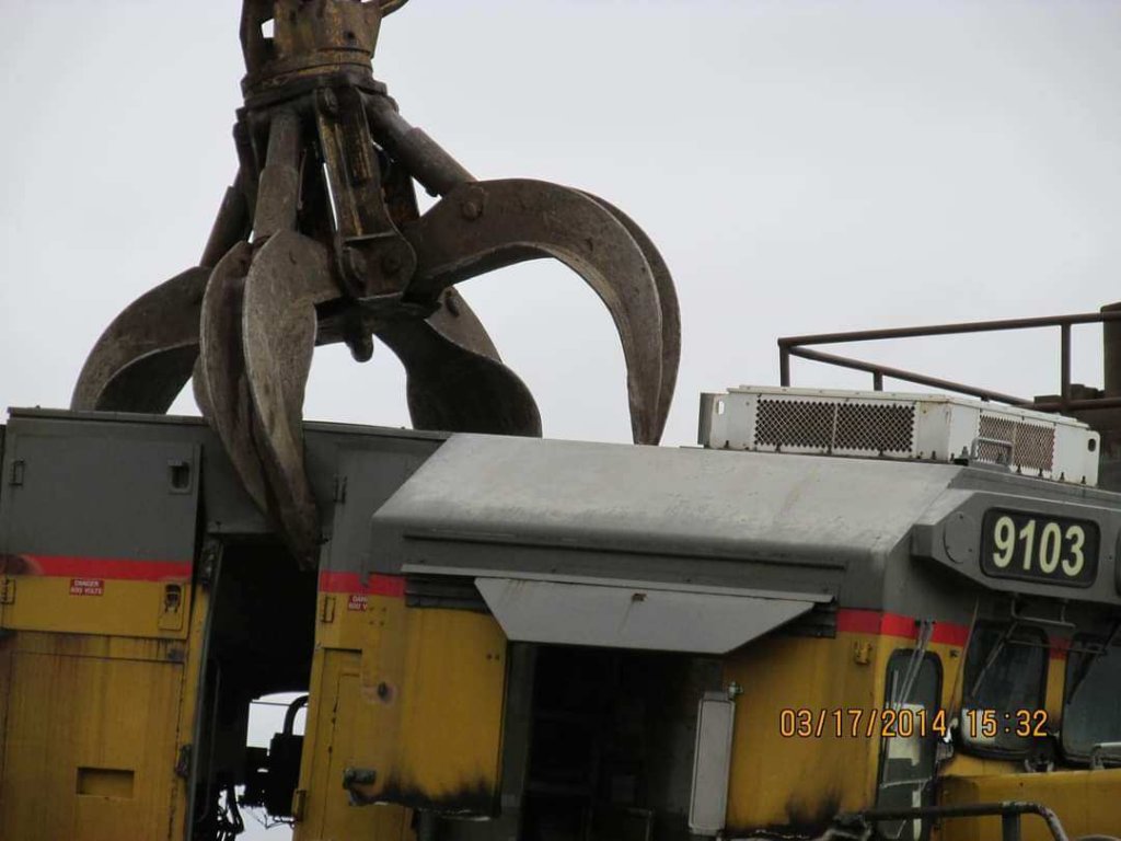

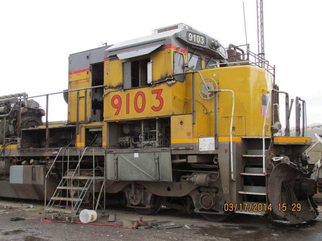

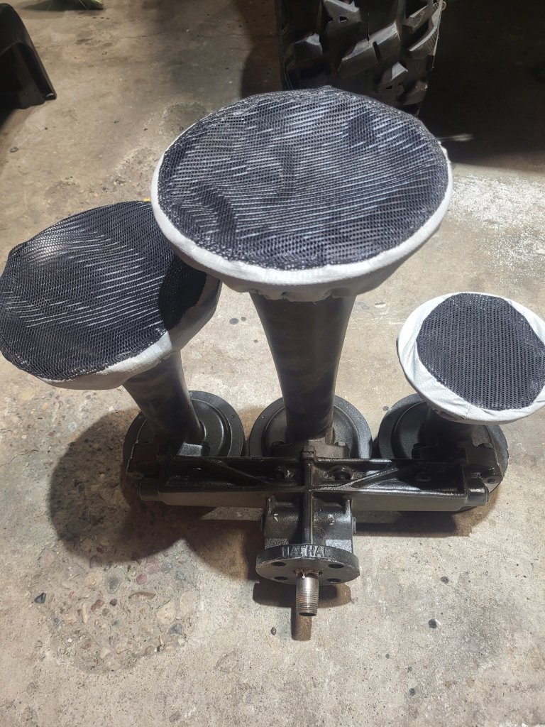

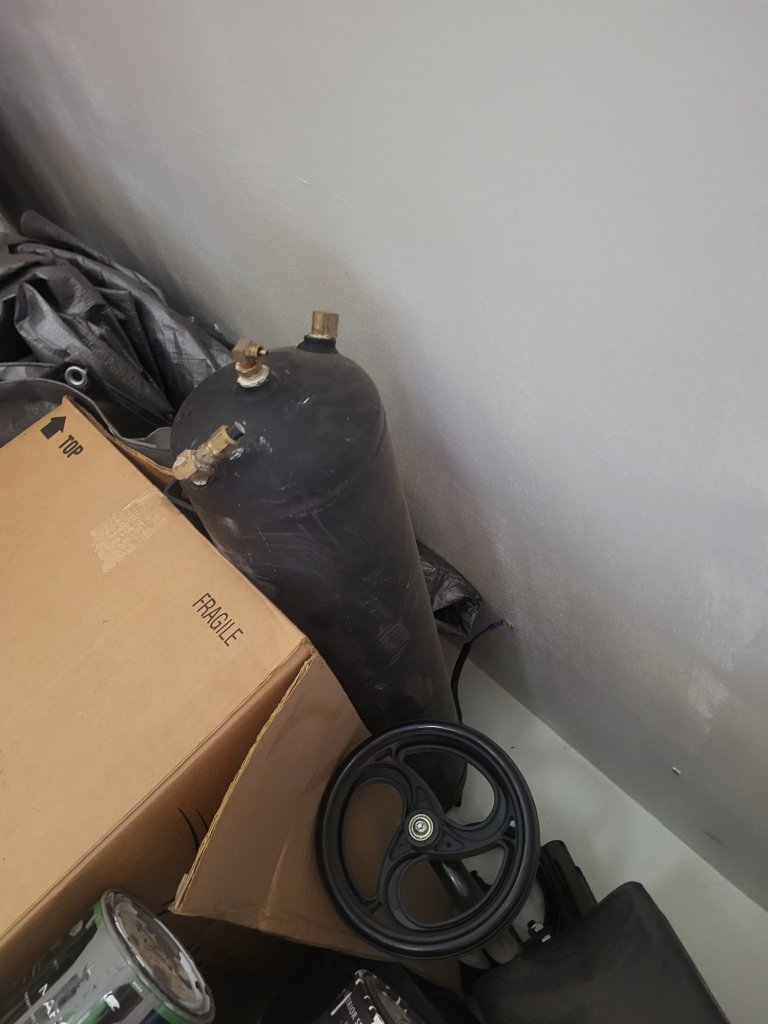

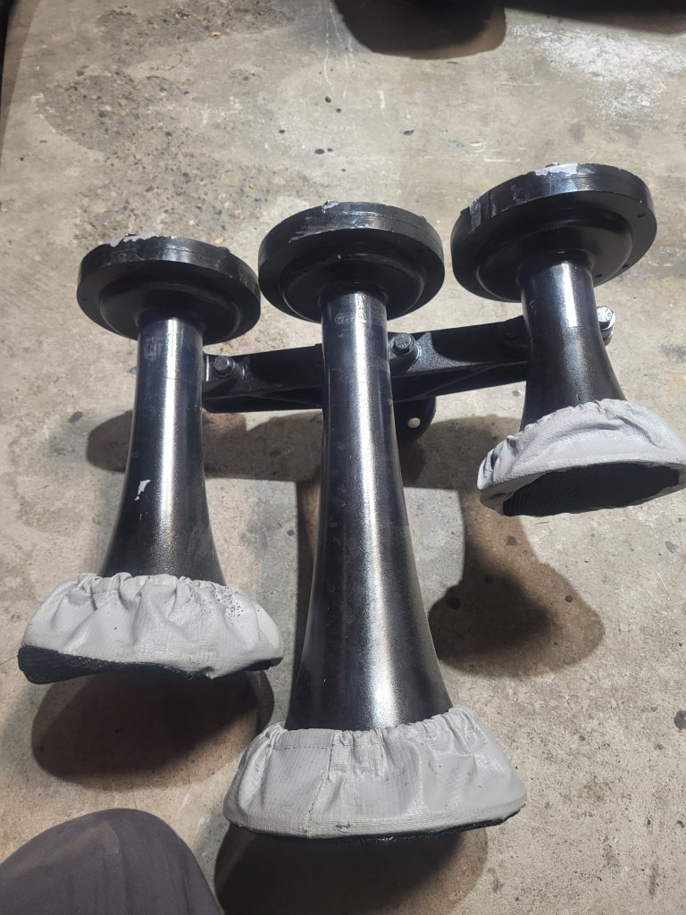

Genuine Union Pacific! This gonna be a fun project. :mexsmoke:

So I didn't realize how heavy these would be. The flange part of it is cast iron. It probably weighs 35-40 pounds.
I also have a shell (cap) on the truck that has to remain. Now I'm thinking I might need to make something that comes up between the cab and shell. I got the whole system, tank, valves, etc. The lines and fittings are at least 1/2 diameter. Hmmm

It's not so much the pressure as it is the flow. If the railroad ran it on 1/2" line an you go to 3/8" it won't be as loud. Tank size will dictate how long you can run it. 20 sec with 1/2" line might turn into 45 with 3/8" an so on.

Kinda what I was thinking. Glad I got it before I buy a compressor. Size is gonna matter ;)

No, it doesn't. Maybe I should mount them out of sight so I can maintain the element of surprise. Plus, I don't know that having them a few feet above and behind my head is a good idea. But damn, they look cool!
