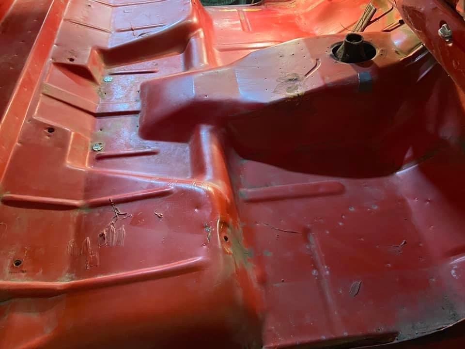

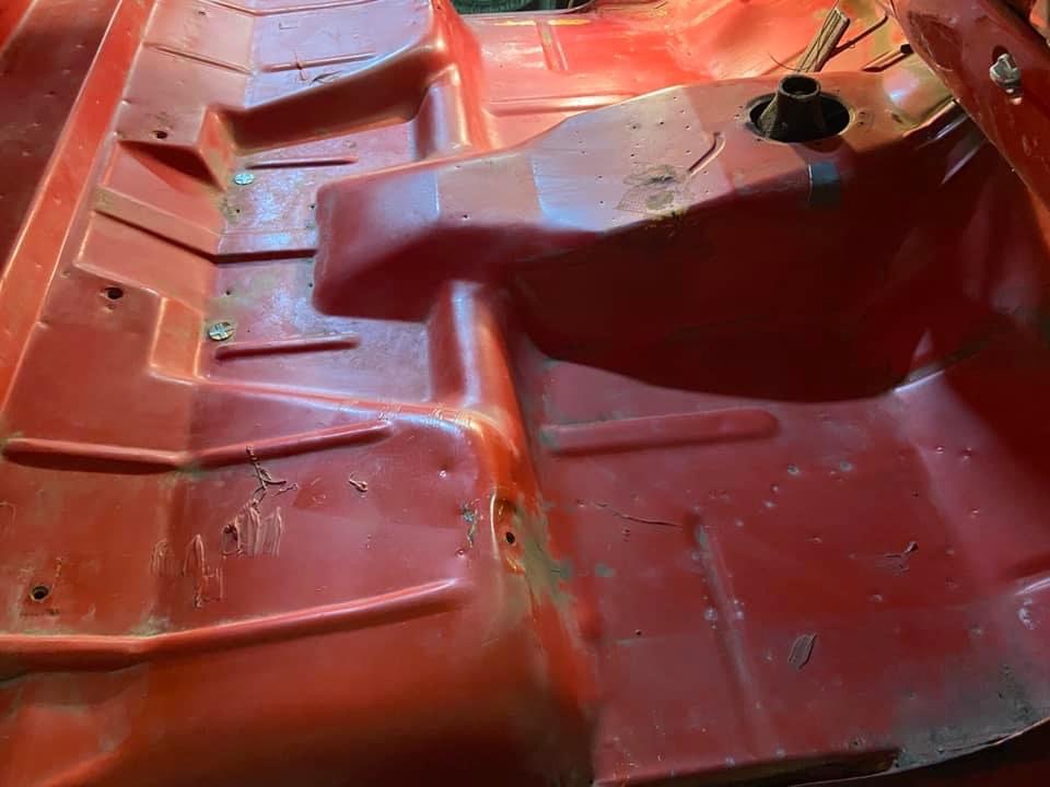

From looking closer to the picture of the 87 4wd /auto there looks to be an indentation where a 4spd shifter would sit so I would agree that they are the same. Parted out a 85 2wd/4spd a few months ago but deleted all the pictures after I sold the cab.
Bingo, looked thru some old posts on Facebook and found some pictures of the 85 4 spd truck I had.

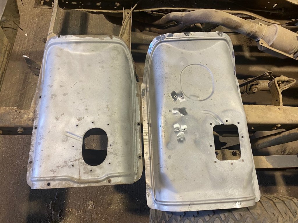

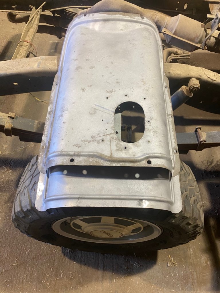

Couple of pics of 73-80 and 81-87 4X4 AT humps together.
