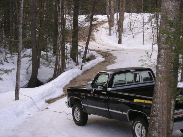

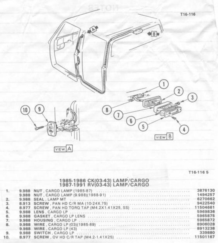

So.. When i picked up my truck it had no cargo lamp on the back of the cab yet the holes are there for it. I found a housing and gasket at the wrecker but it was inside the cab and there was no bolts or mounting system for the fixture. Does anyone have a picture of what the fixture should look like? Thanks in advance.
