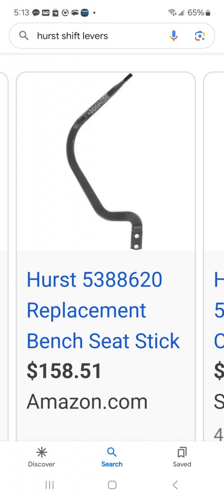

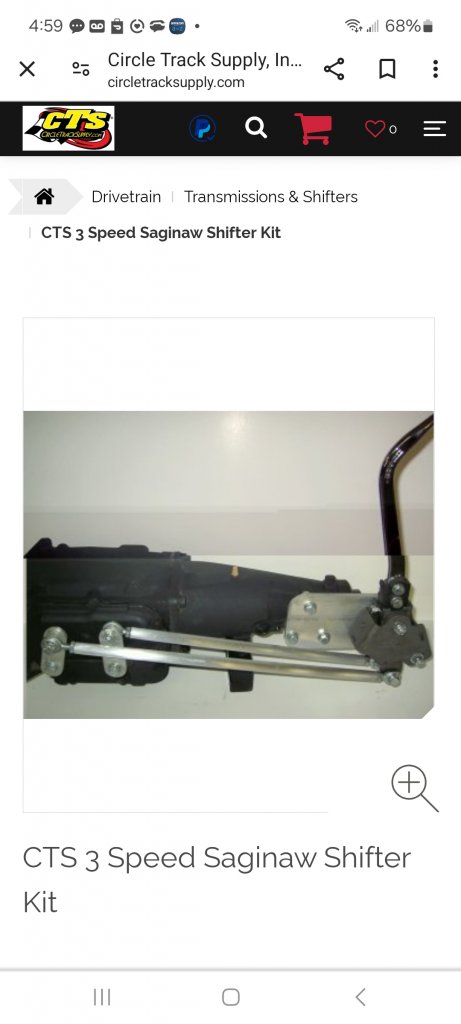

I'll put a pic at the bottom. What year is your truck? Saginaw should be an easy bolt in common sbc bell housing,a pressure plate and flywheel to match your engine,a starter to match your flywheel and a clutch disc to match your transmission.The pic I'm putting up is a 3 speed saginaw,but you get the idea. You may have to make a bracket and shift rods to get the shifter where you want it. Also Hurst shifter have many different Shift lever designs some are like a big c that will clear a bench seat.

Tri five Chev style have the big "C" shifter handle.....you can always build your own

John, I recently pulled an SBC, 4 speed Saginaw, Hurst competition plus shifter and driveshaft from a 77 shortbed with bench seat. I first had a car shift arm but it was very a long reach to get into third. I later built a custom shift arm that curled around the seat a bit. Engine and trans sold already, but if you are interested in the driveshaft, let me know. I'm in North Jersey. Thanks, Rick

Thanks for the input, guys. I’m thinking the 57 Chevy curled shifter handle would be the way to go. I’ll send a message on the driveshaft.
