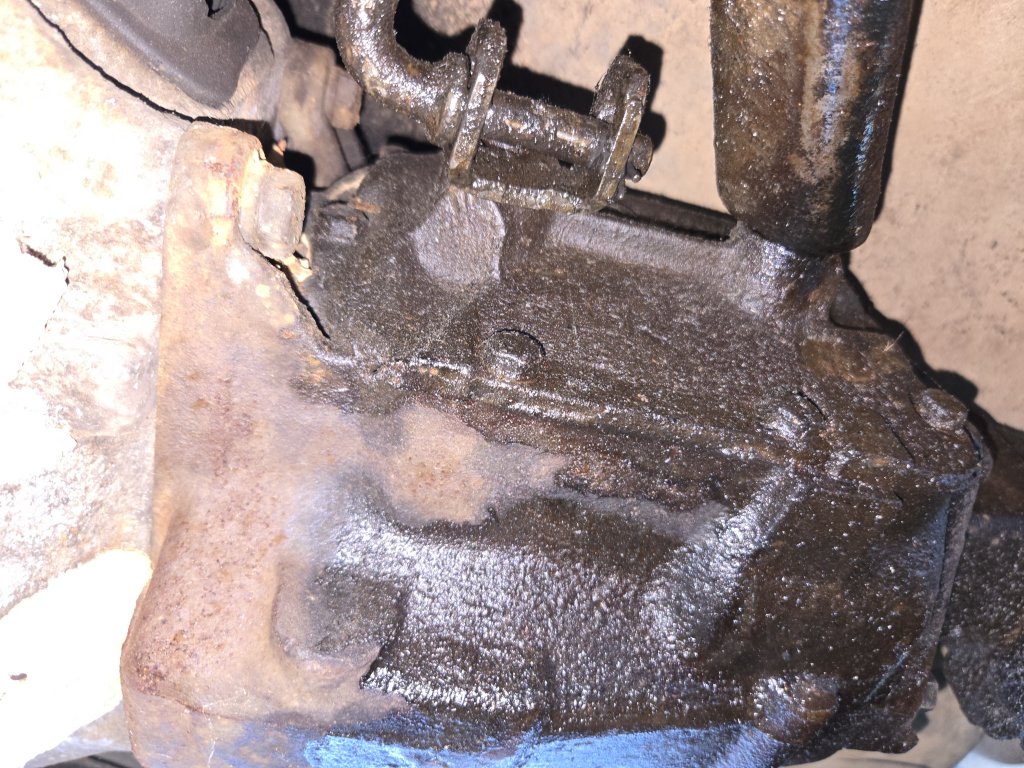

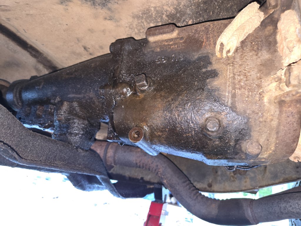

Thought I'd give an update and beg for more info. The bottom right tail housing bolt was the charm. Once I knew where to look,
it seemed kind of obvious. Anyway, got her drained and refilled with synchromesh. Thanks again Turbo and others.

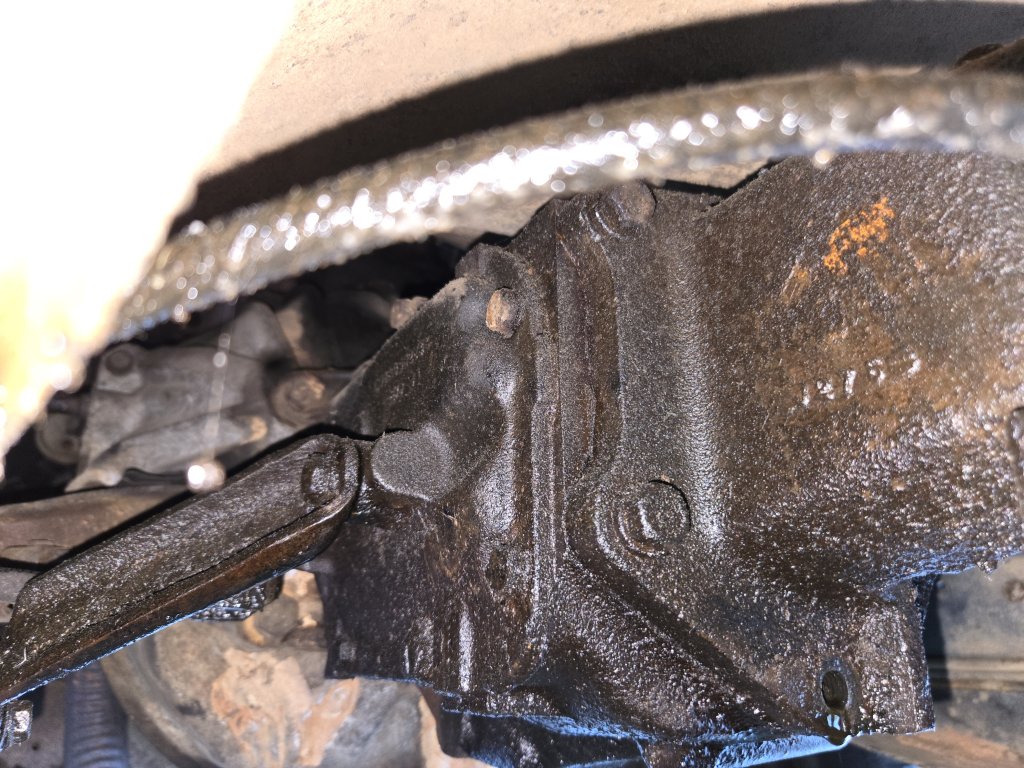

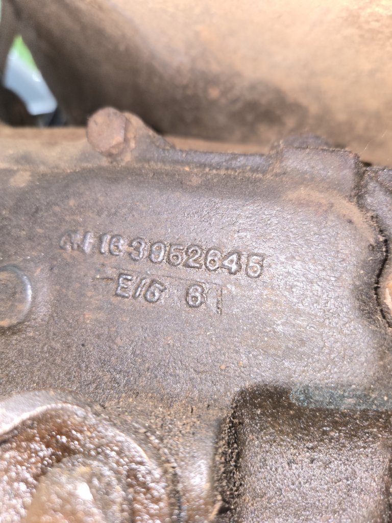

I could not find a sticker with codes on the glove box. Only sticker there referred to Truck Camper Loading Information. I am sending pictures of the 3 speed trans. If I can't locate a trans of the type that was from factory I'll just keep this one. It obviously needs some seals. Its only problem is the synchronizer when down shifting from 3rd. Not hard to avoid that and when necessary, double clutching seems to help. I said I was going to beg for more info.....I'm including some pictures of the trans that possibly some of you fellows can help me ID it.
Cheers, Selo

Modified question....I know it is a Saginaw, but is it identifiable as an older version of the Saginaw 3 speed? Could this model have been OEM in my 1984 truck?
BTW, with new Valvoline Synchromesh oil in the trans., my synchronizer issue is gone!
Cheers, Selo

Those truck Saginaw 3sps were very desirable way back when circle track racing. A bunch of different version/gear ratios.
If I remember correctly we’d pull the cover and count some teeth, we wanted a 1:68 second gear?

Looks like there might be a date code? It's upside down. Too blurry for me to read though.

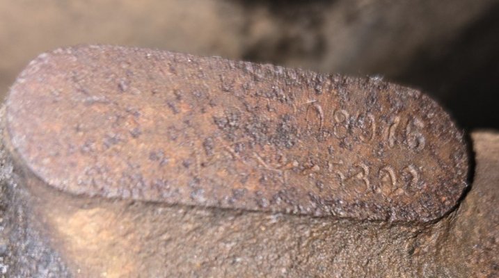

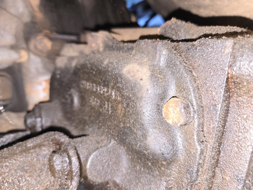

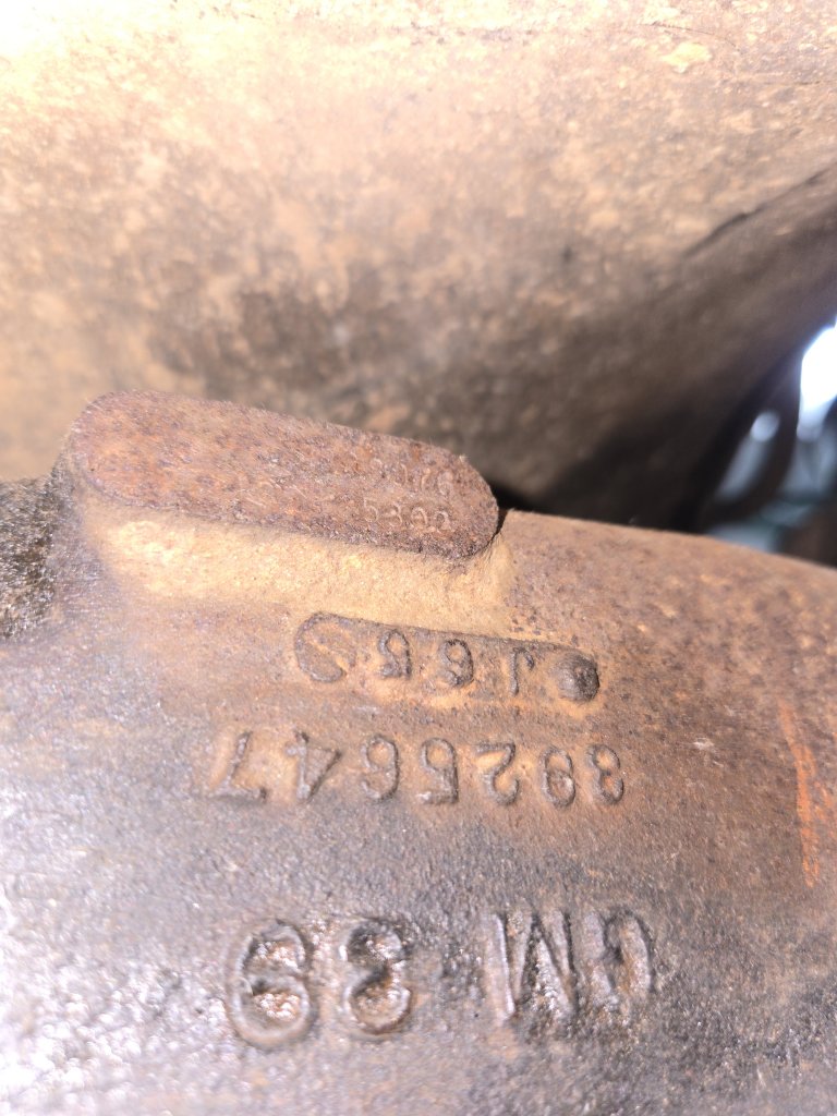

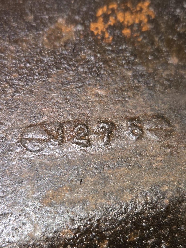

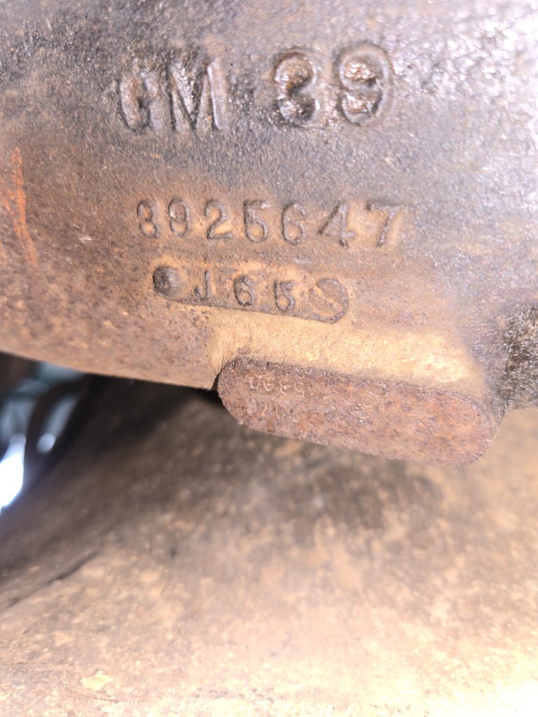

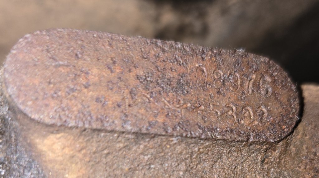

So, to the pictures....I am hoping the castings and stamp on the transmission will tell me more about the units age. Any help you may provide will be very appreciated.

I believe that's a date code for either October of '75 or October of '85? The J 6 5 code is on the main case, but what is the J 27 5 code on?
