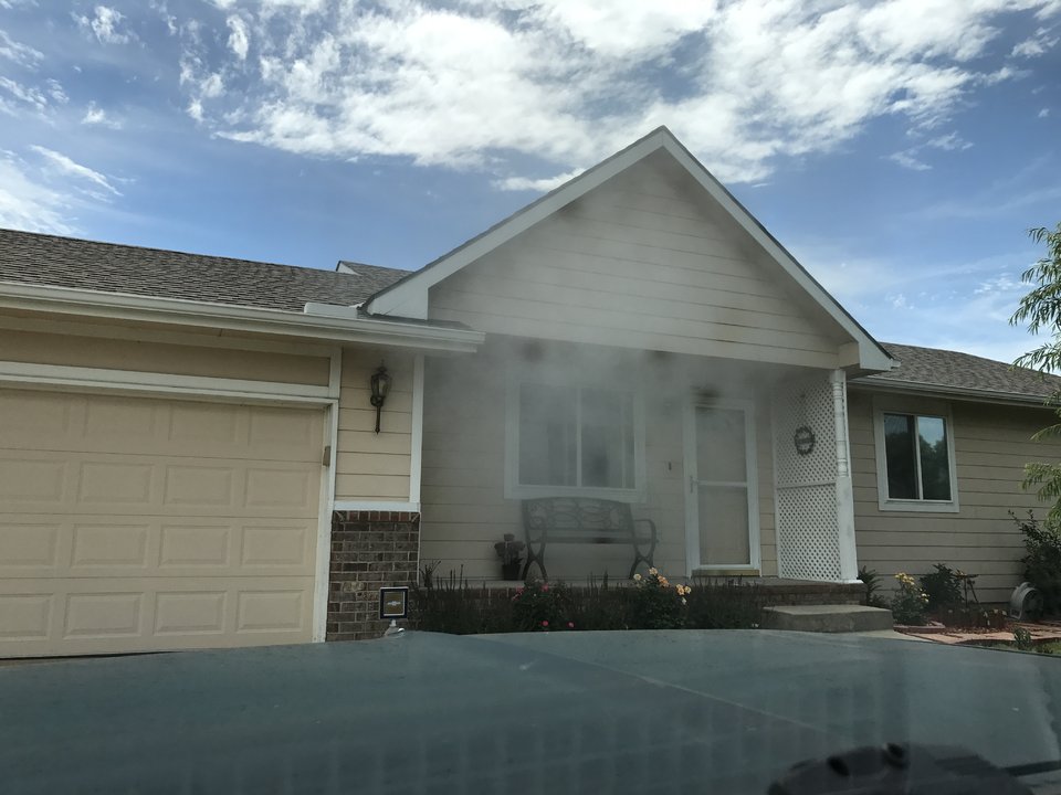

If you zoom in to the right of steering wheel, that is what I am dealing with.
https://drive.google.com/open?id=0B7iQnlFQvJfMOWV1eW14UDJzMTg

Here is a pic of the spot I am trying to clean up.
hmmm, I'm wondering if you just don't have a bad windshield. It's very possible you know. That doesn't look like paint in the pic. That looks more like a fog. Safety glass or windshields are made of laminates. That is so when they break they shatter and crumble. You might have a bad windshield where there was some moisture between the laminates that didn't dry properly and left a fog between the pieces.
Thing is, I can feel where it starts and stops. I can leave finger nail scritches in it, too. I have 10 days of vaca starting in a few hours. Ill have plenty of time to figure it out.
