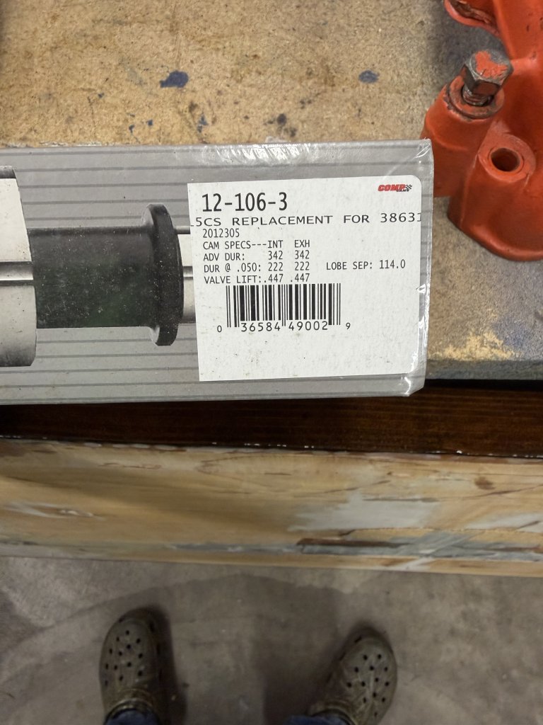

Drivingjenny
Sep 26, 2025
Longview wa
Aaron Hartley
359
Sorry I have 202 heads and engine is 0.400 over have a brand new cam already was just hoping for maybe better one mine is

Those specs are almost the same as the old 350 horse hydraulic 327 cam.......L79 option......good cam!!

You said you are “building” a 350, so does that mean you are replacing pistons or making other changes that would increase compression or improve head flow?
That 222/222 cam works with a stock low compression engine, but as Ricko1966 said, the low compression heads are a poor match to that cam. GM used a similar duration cam in the 350/290 hp crate engine, but it sounded better than it performed because the compression was about 8.2-8.5.
Back when these engines were new they used to swap in what was called an “RV” cam, which was usually a duration of about 214 to 218, and it seemed to work well. You also need to consider your gears and transmission. My K25 has 4.10 gears (good), but a stock TH350 and a lot of weight to get moving. It pulls well, but will never be quick.

The cam you have is a nice choice for a basic 350 in a truck.

I'd rock the cam you already have, it's a good cam
2.02 is valve size what are the head casting numbers and are you running flat top pistons? If you are running large chamber heads and flat tops that engine is basically a clone of the 350/290 hp gm crate engine do some internet research regarding that engine and Camshaft. I say that engine needs more compression or less cam.
