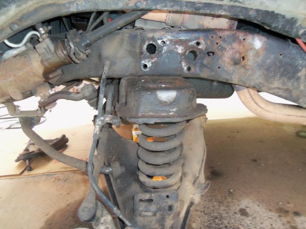

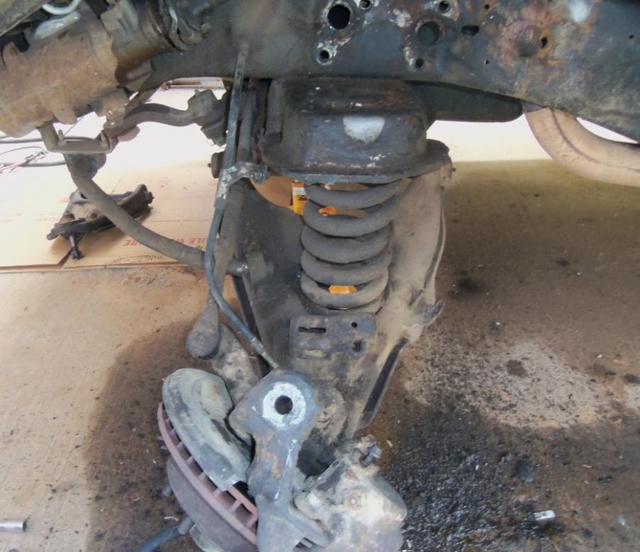

Surgery is well underway, but I didn't get near done what I wanted. This is a real bitch with the A arm being on and not able to come off, the fender well, motor etc all in the way. However, with mega doing and mega time, I did get the bad bracket off and out, the A arm off of it, also put tack welds on the back of the donor bracket studs and paint the back of it so it doesn't rust. In the morning, it'll all be about reassembly.

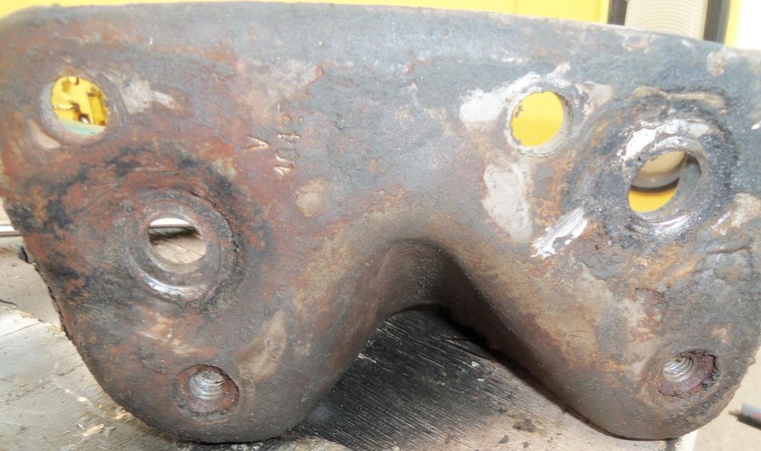

Here is the old bracket. Noway in hell buying new studs woulda fixed it. The holes are egg shaped and bored out bigger. The studs didn't look near as bad as I thought. They are pretty damn hard. Took 2 sawzall blades to get thru 1 stud. They are hardened to hell and back, and super strong. Also might be why the welds don't stick real well without a lot of heat or amperage.
