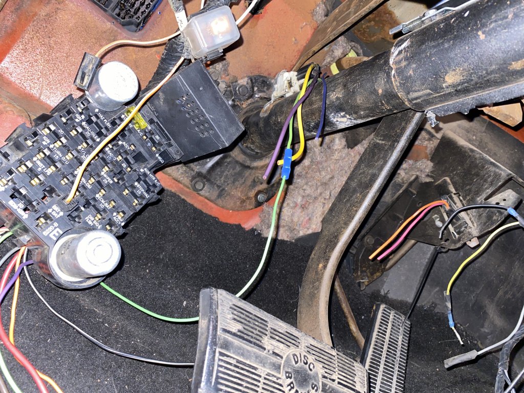

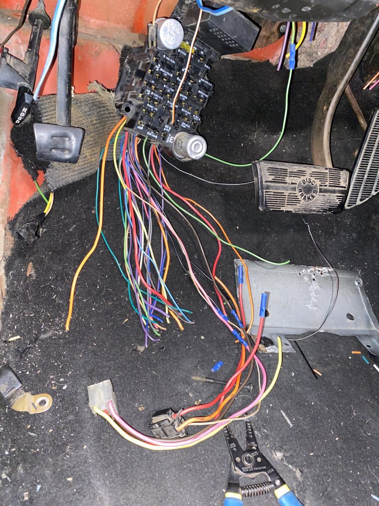

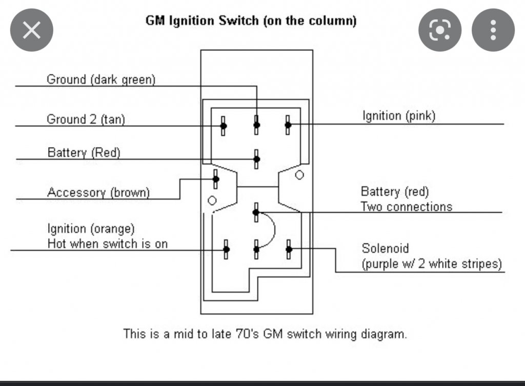

does anyone know how to wire or know the color codes for the steering column and ignition key switch
