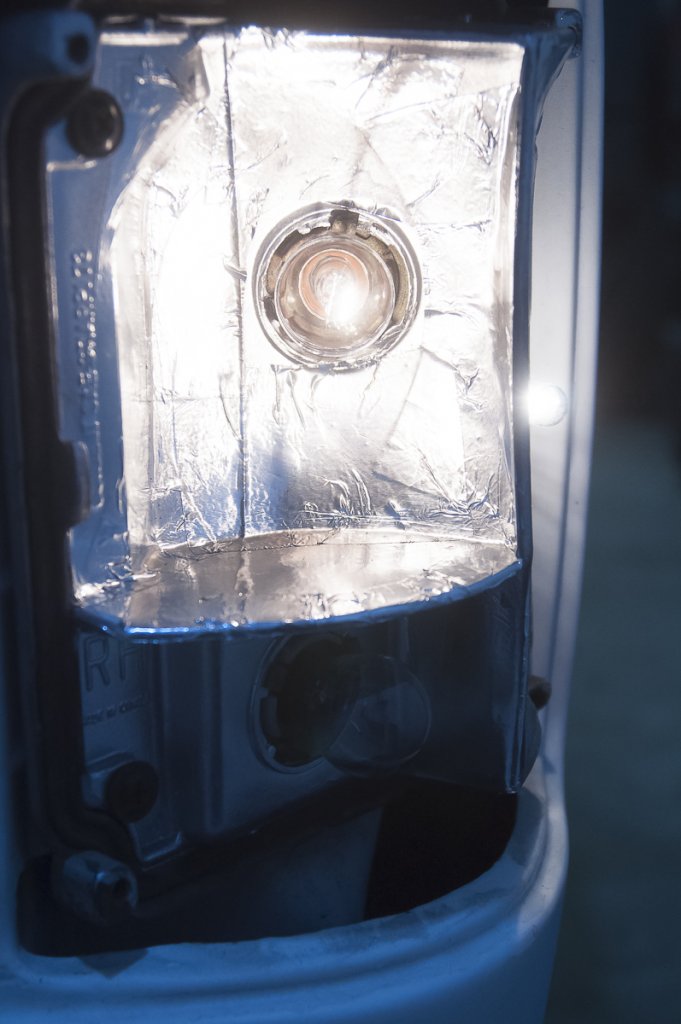

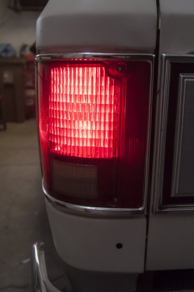

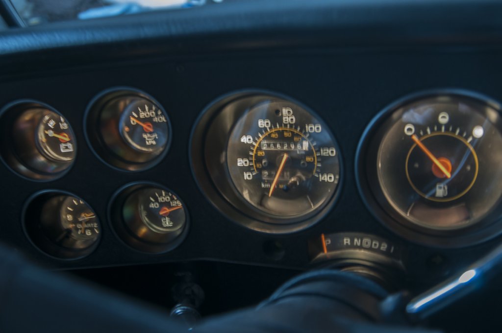

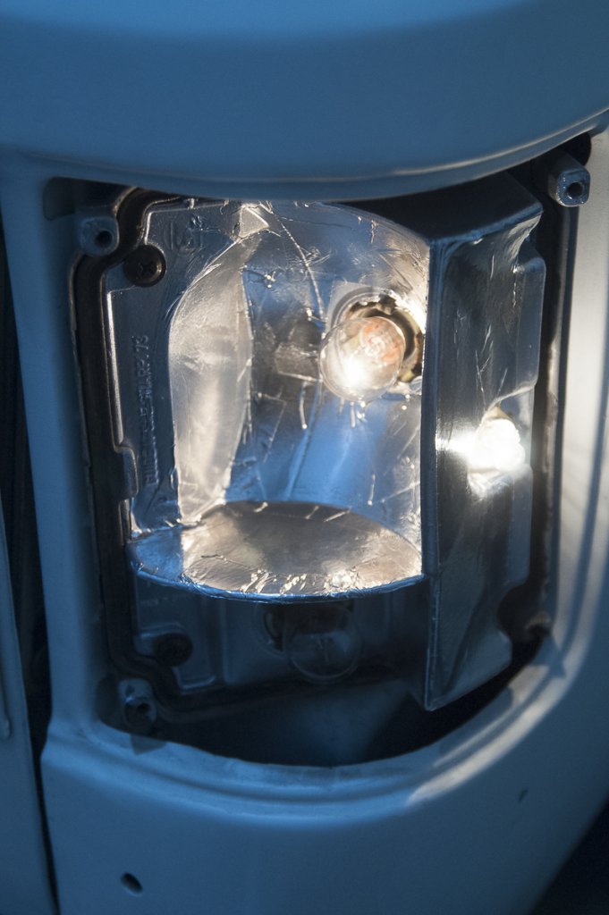

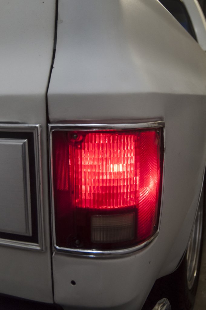

All wet and raining here so I was just tinkering around inside the house. I painted my faded gauge needles the other day and haven’t put my instrument cluster back together.
Was thinking about a conversation we had the other day about using aluminum duct tape inside tail light housing to reflect light outwards.
So I decided to line the underside of my inner gauge bezel. Figure it can’t hurt. Why not see if it will improve illumination.
did the same on mine..make a big difference! so i do the tail light too! :)
