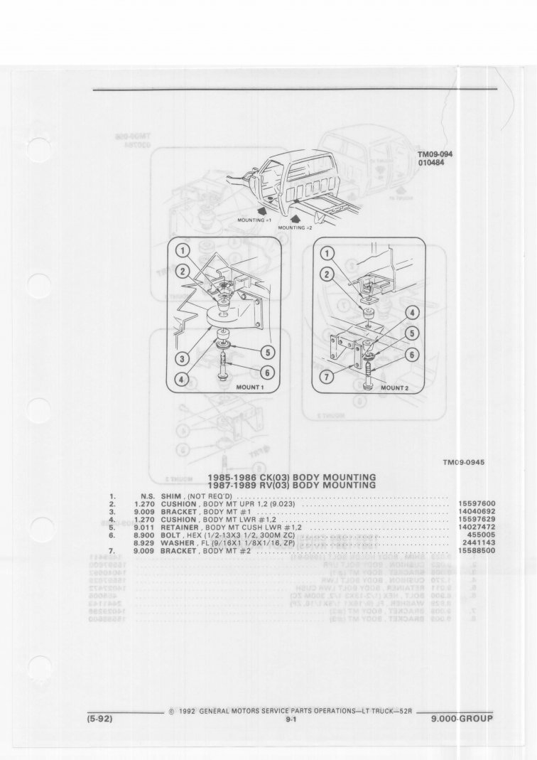

I can't say for sure about the earlier series, but the 81-87 mounts are just like the front. The bolts are screwed into those flimsy flat squares that are encapsulated within the body cavities. If they twist free or won't budge, it might be best to cut your losses and just cut the bolts. Then try to shove them and the square nut into the cab support and out of the way. When it's time to reassemble, you'll have to cut an opening to drop in new nuts and get a wrench on them. Just my thoughts, someone else may have a way better plan. Here is the setup for the 80's series:

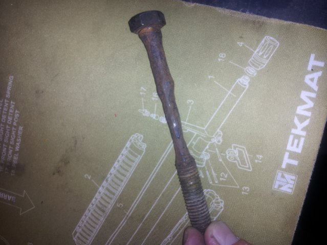

I had the same problem i measured from seat belt bolt underneath to the mount bolt then went inside measured the same distance up and back. I used a one inch hole bit landed right on top of it. Then wedge a pry bar and impact it off. .....my front mount bolts where so rotted they were less than half the size they shoulda been
