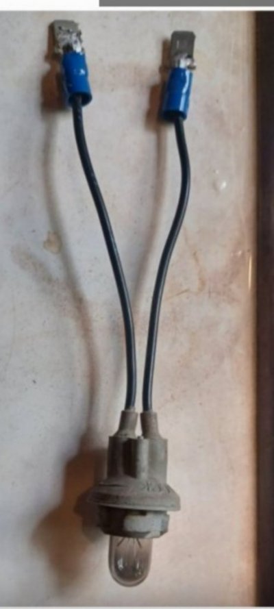

Replace the fuse with this,it's a 194 bulb and socket. When the light goes out you found your problem.Its easier to check than the fuse and will save you lots of fuses. Put it in the fuse box do what makes the fuse blow it will come on when the short appears,shake any harness you can grab or have a buddy shake or have a buddy watch,watch for blinking light. Your short is in that harness. Start taking things out of the circuit one thing at a time until the light goes out,when the light goes out you found the problem. Lacking a buddy just make a light with longer leads.

The recent work that has been done is spark plugs and wires that was about 2-3 weeks ago so I’m not sure if it was that but I’ll look into it. I’ll try running it without the bulbs and use the 194 bulb while shaking the wires in today or tomorrow to see if that helps locate the problem. Thank y’all for the help!
