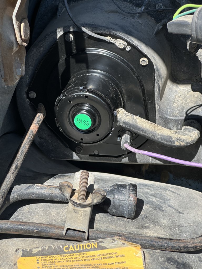

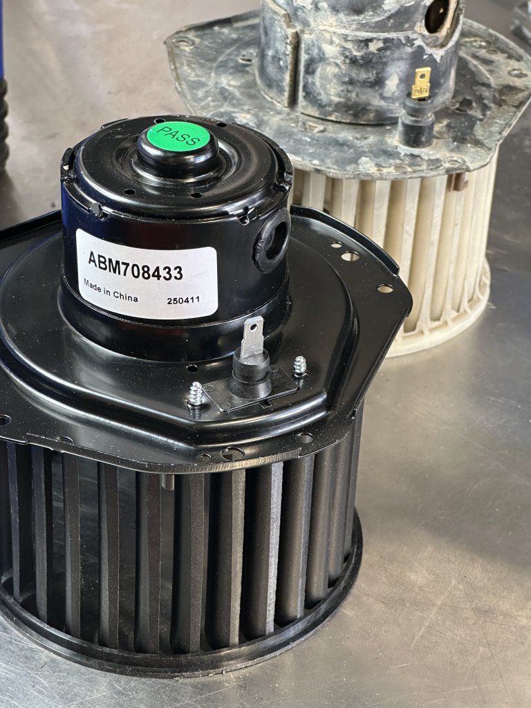

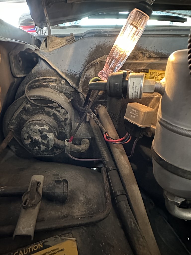

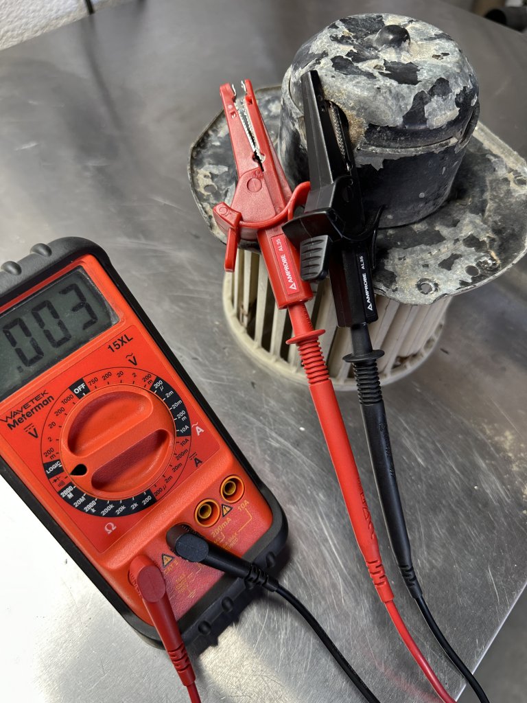

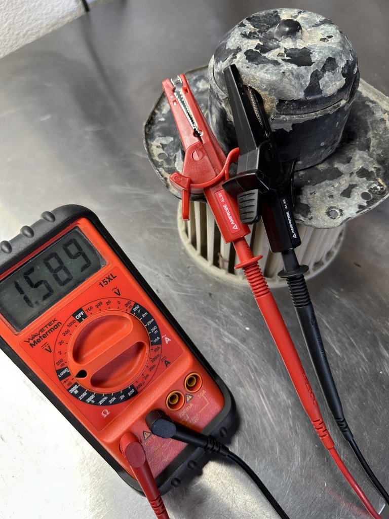

Once blower motor stopped turning, I checked the cheap and easy culprits first:
☑️AC compressor still functions-check.
☑️Fuses-check.
☑️Power to purple motor wire-check.
☑️Check ground wire to motor-check.
☑️Test continuity of old motor-no bueno.
☑️Replace blower motor-check.
☑️Functions as expected-check.
