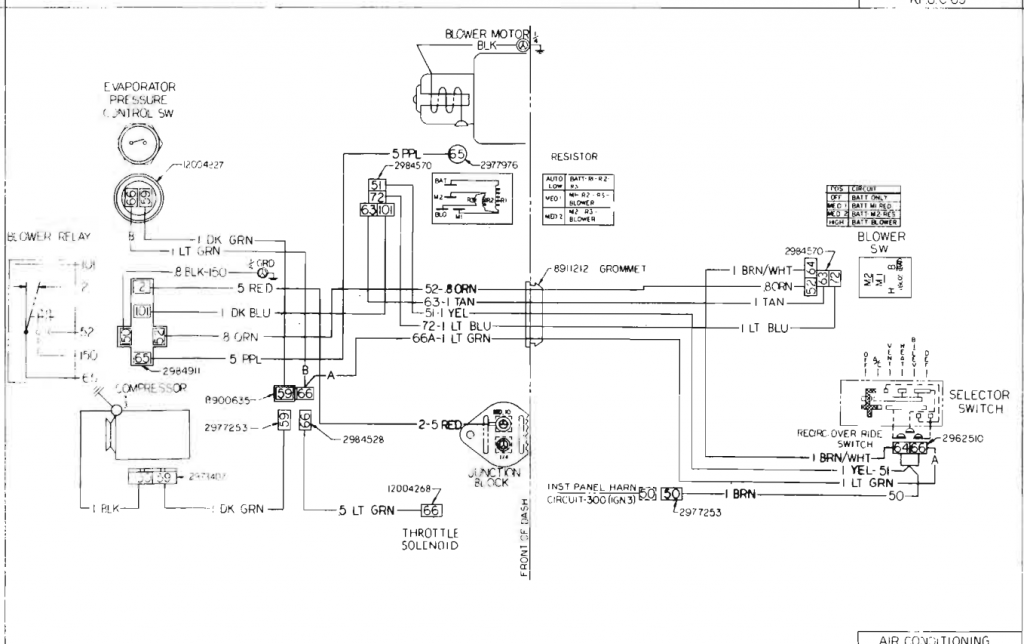

I believe you should have power on the yellow wire at the resistor (all the time) once the key is turned to run position. That is why the blower runs all the time on the older squares bodies. I would check for power on the yellow & brown wires on the selection switch next. Also the fuse you mention- is very suspicious-That is the one that feeds your A/C- Definitely make sure it has power there and making good contact with the fuse (should be 25 amp).
Attaching wiring diagram in case you need it.

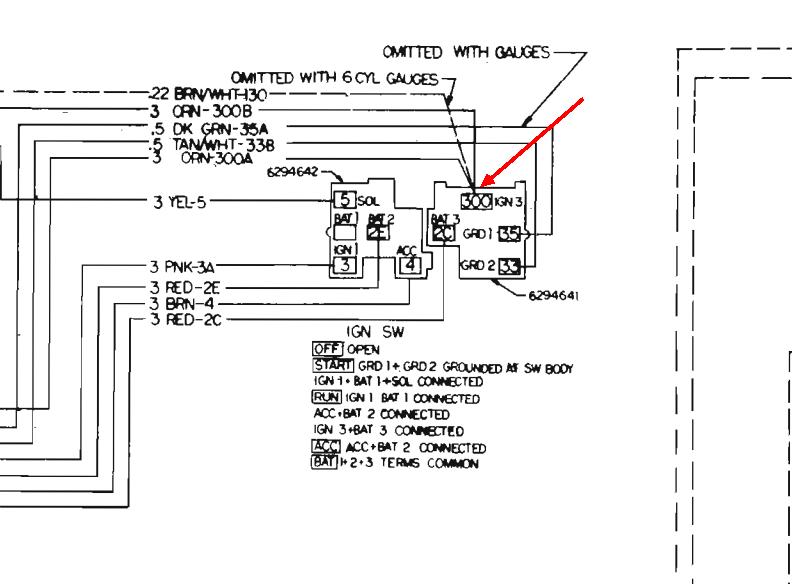

This could cause heat build up- on the loose side squeeze the connector to make it tighter. The thick orange wire is coming from the Ignition Switch. When you jump something directly to the battery you are removing the safety feature of the fuse- If you aren't careful you will cause damage.
