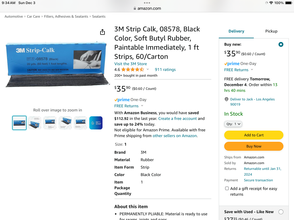

I used plumbers putty tape readily available.
Maybe what u are calling dumdum....

Here you go
oops, missed the previous post

"Back in the day" we called it dum dum......probably not politically correct anymore.......with dum dum in office!!!....lol......and thanks to @1980 Big Ten and @Loren for the info...this is a GREAT forum!!!!!
