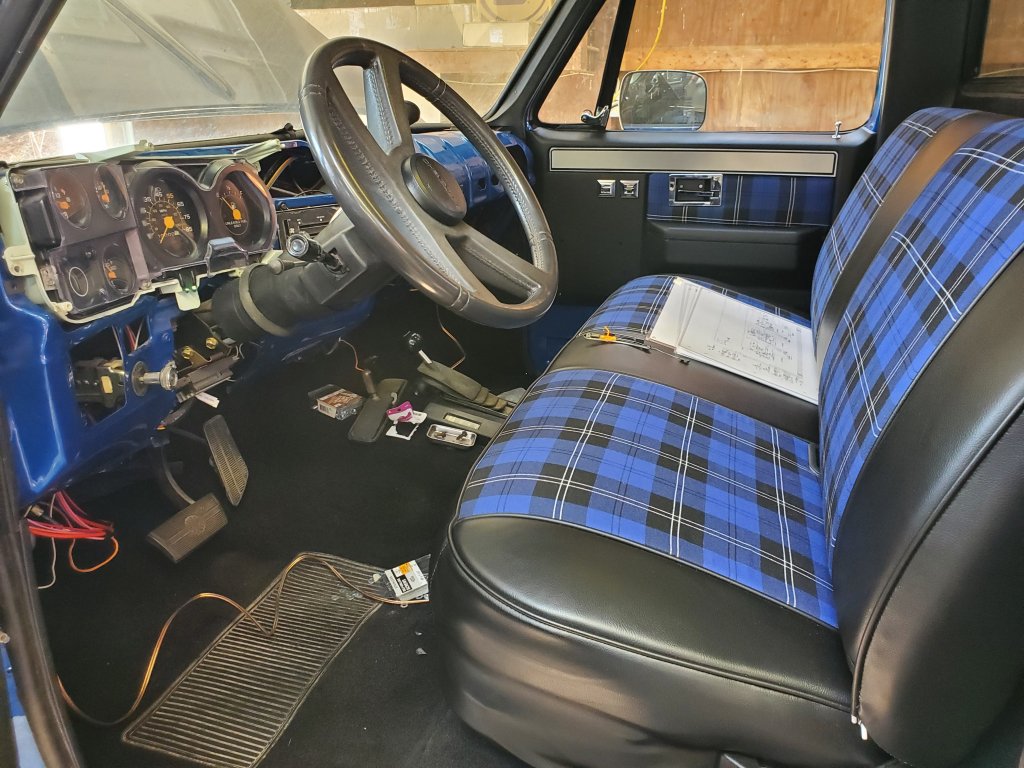

Big fan of plaid myself, and there are some nice options for orange and white. I got material from here: https://www.scotlandshop.com/us/tartan-finder. You want to go with polyviscose material. I personally ordered swatches to find which color I liked best. Then I ordered a seat cover from https://www.etsy.com/shop/B62upholstery?ref=shop-header-name&listing_id=855486376 and told her what plaid I liked. Turned out pretty nice!
Here is a pic of my interior
