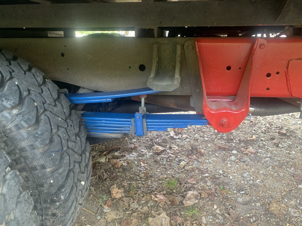

Looking from underneath, are there holes in the top frame rail for bed bolts? If the answer is no, you have a c&c, and they were not designed for a normal bed.
Look at the gap from inner tire to the frame. Huge gap, normal truck. Tiny gap, c&c. Example shown is a gmt400 c&c, but the same principle applies. There were a few special order normal bed trucks with a c&c dually axle and metal “flare”, but the odds of actually finding one outside of the Saudi oilfields or rotting in a government yard are astronomically low.

Most all 80s front clip parts are interchangeable. As for your other question, not sure anyone understands what you’re asking, but if it’s “Can you replace a 12” long stake bed with an 8’ long pickup bed?”, the answer is NO, not without a lot of cutting welding and modification.
If you have a 12’ bed now, it’s a long wheel base C&C. Prohibitive to modify into a pickup truck IMO unless you’re good enough to be cutting and welding frames.
