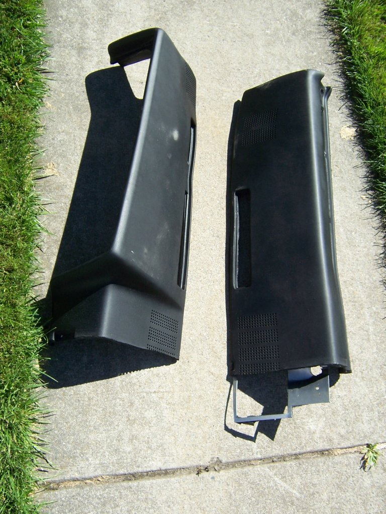

Cut the new dash in 1/2. Hope I get the money back. Will report here what happens.
There are some previous comments on USA1 being decent quality. Giving them a try, ordered one yesterday.

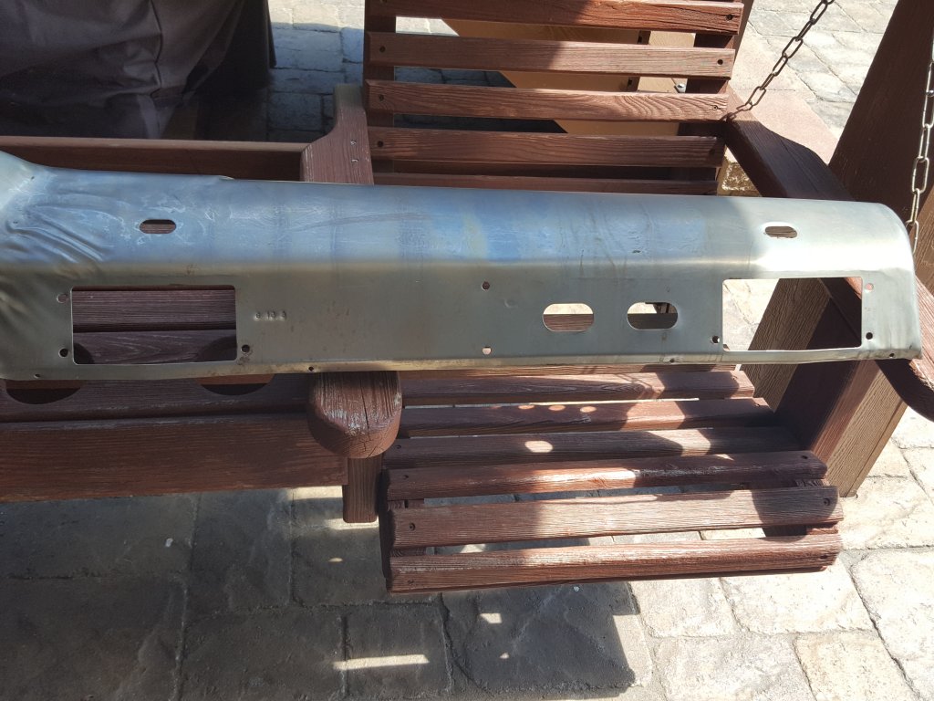

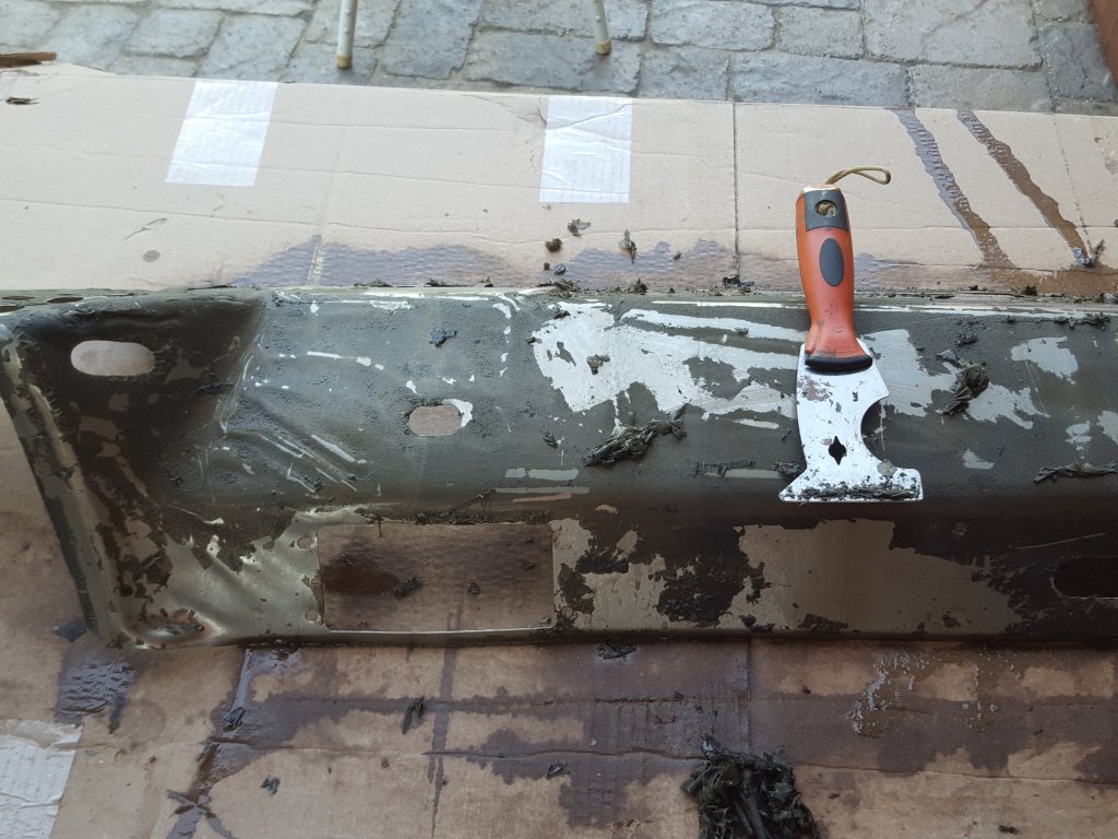

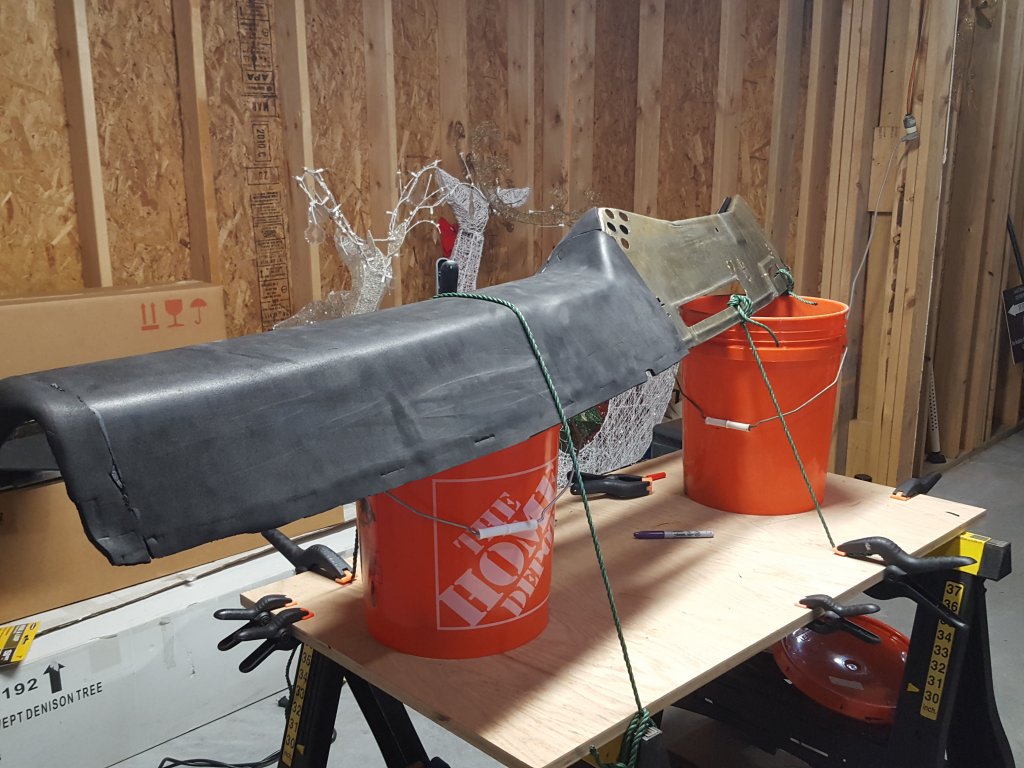

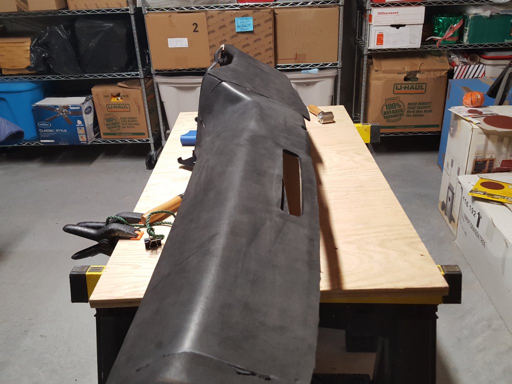

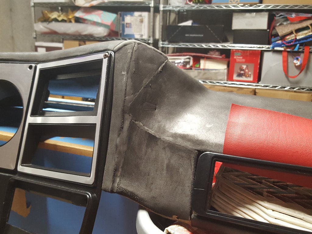

Strip down to bare metal, apply new high density foam and re-cover in vinyl.

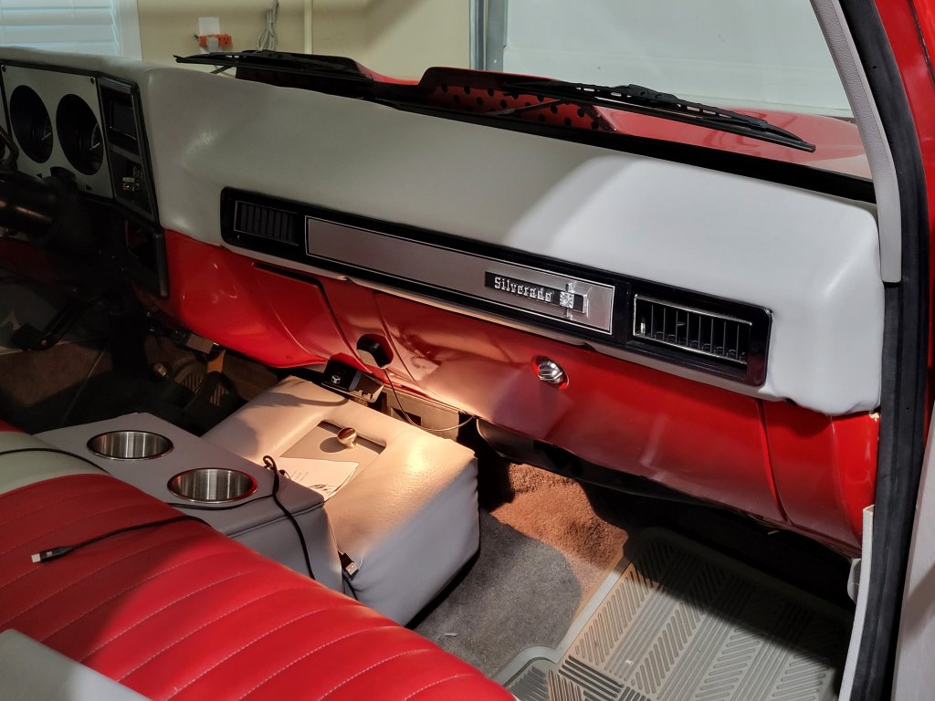

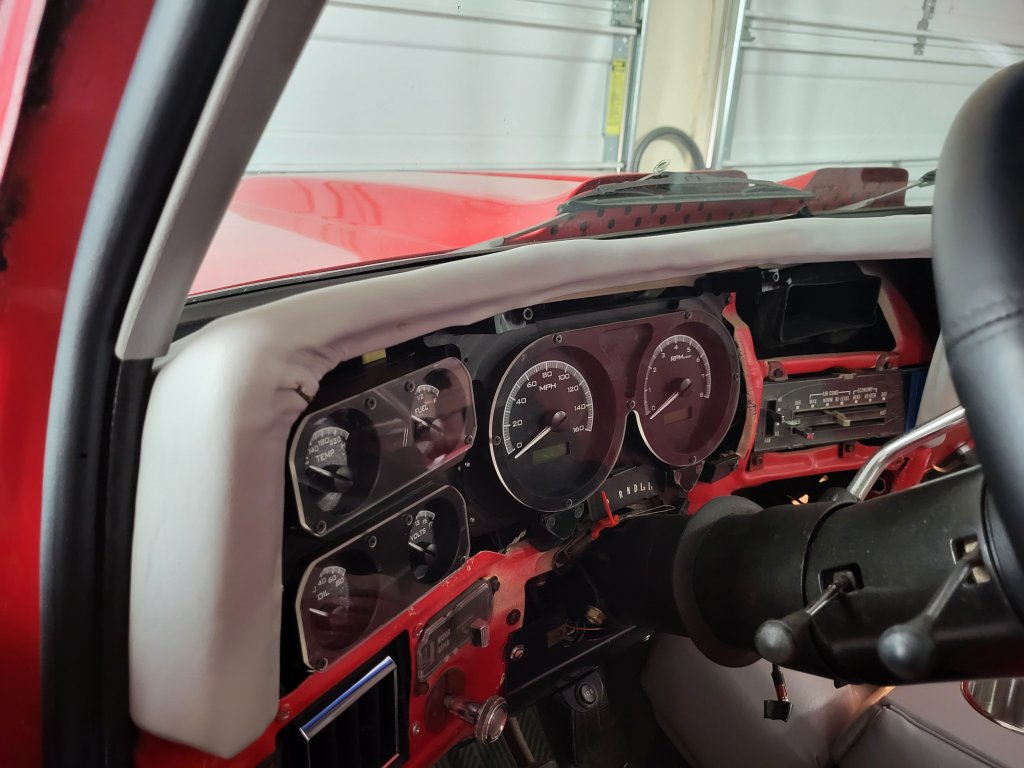

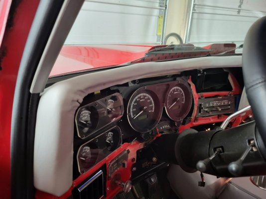

Recovered with marine grade vinyl.
