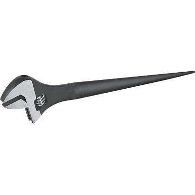

As long as the trans mount doesn't get bound up by moving it. Can you just use a spud to align one of the holes so you can get a bolt in the other?

whats a spud? I can get two bolts in on one side but the other is about 1/8" off... thats why i thought about drilling the crossmember bolt hole larger...

Put the two in you can and leave them loose. The spud tool is a pointed spike basically to pry to crossmember into position where you can put a third bolt in and the pull the tool out and put the fouth bolt in and tighted them all down after that. Mine was bent towards th back some and i hooked my winch cable off my rollback to it and wedged the back tires againts the bed and pulled slight pressure on it towards the front and got it pretty close only to bend it back again about a week later playing in some rock piles out behind the shop.

The local Tractor Supply has these spud wrenches in their bargain bin as of earlier this past week...
attachment.php
