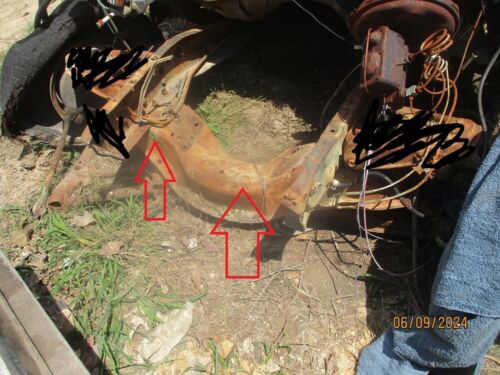

There's one on fleabay. It's pretty crusty too, and $430. But free shipping.
Man I sold a whole front frame section (complete suspension minus steering box) from the 85 I parted out a few years ago for like $150. Way less crusty too.
I guess inflation or supply and demand.
