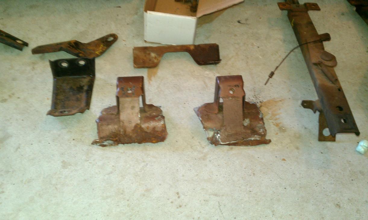

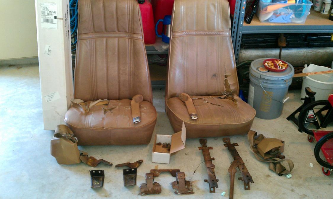

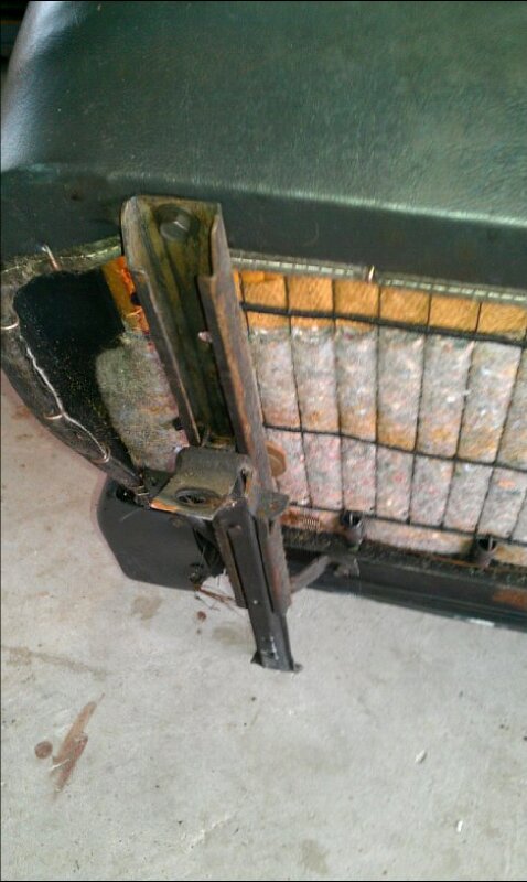

This is the factory buckets out of a reg cad how I got them with ALL the brackets etc.
attachment.php
Close up of brackets, tracks, and floor perches.
attachment.php

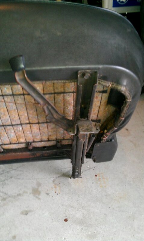

Bench seat left side.
attachment.php
Bench seat right side.
attachment.php

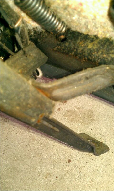

Rear part of bench tracks.
attachment.php

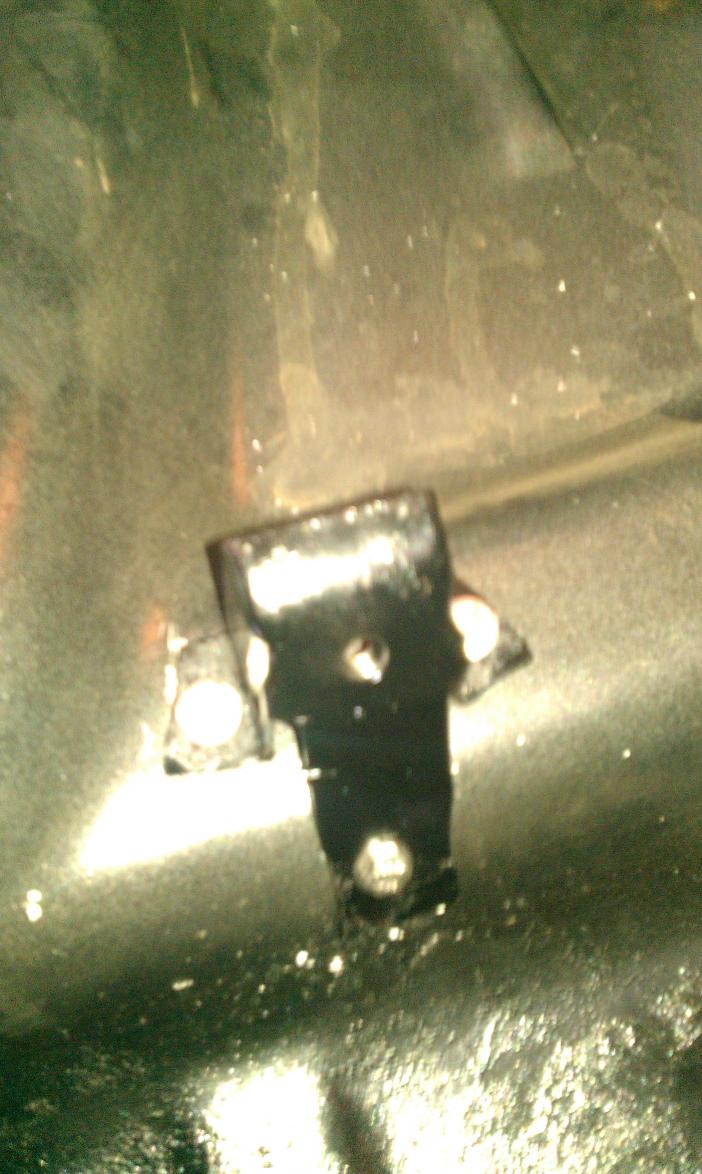

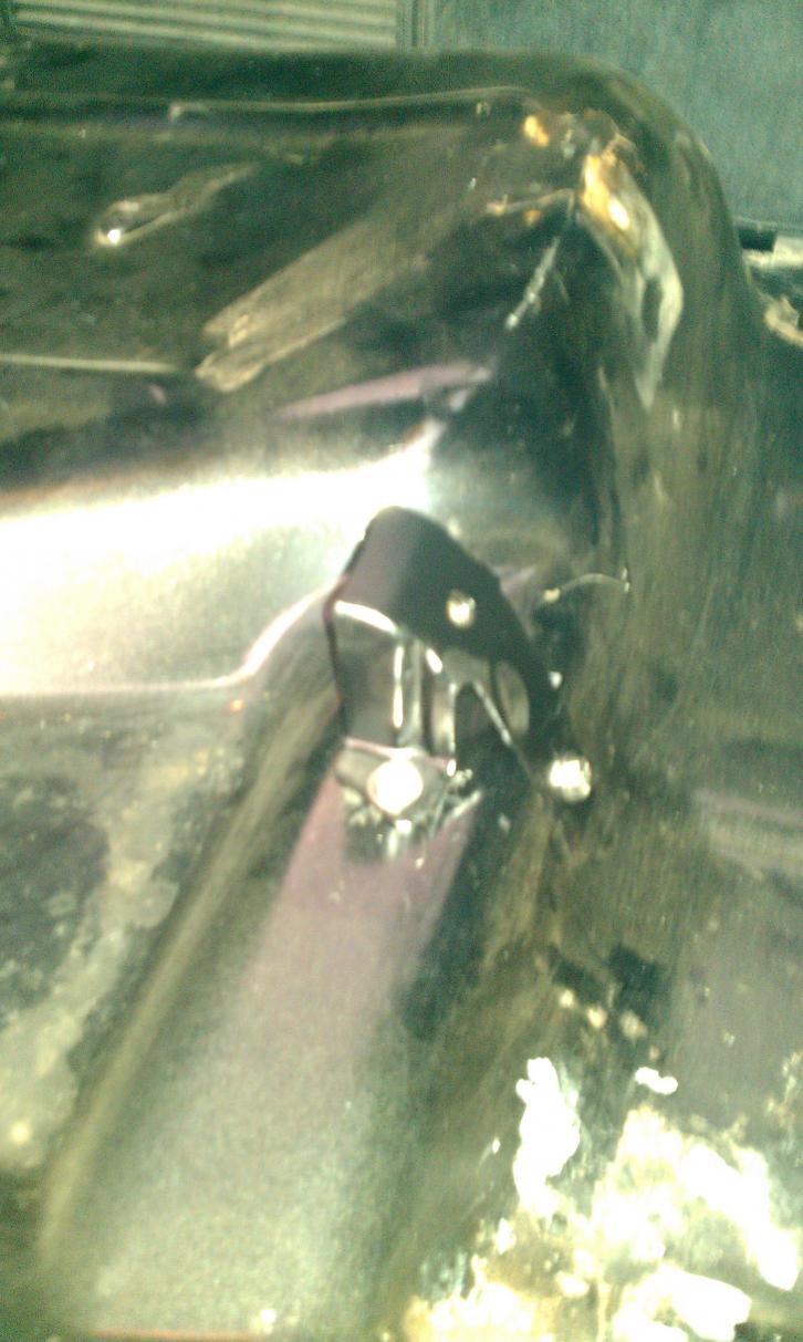

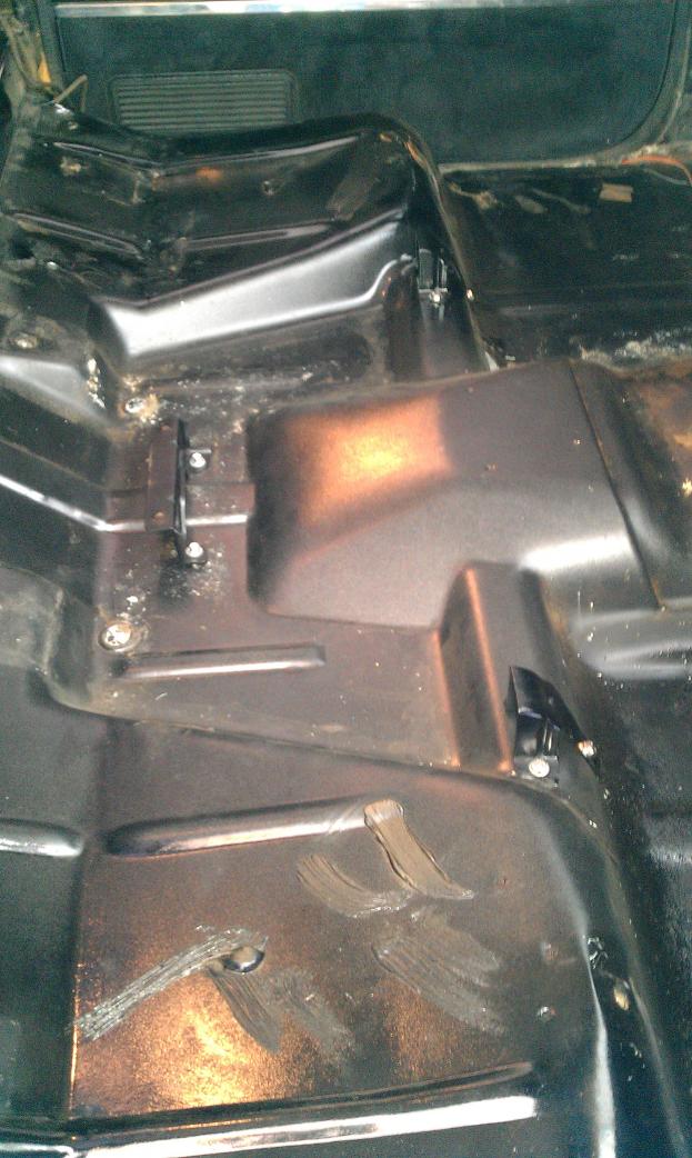

Floor perches installed.
attachment.php
Floor perch close up.
attachment.php
attachment.php

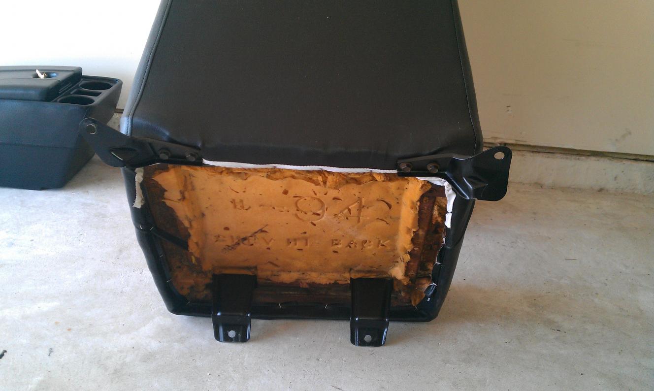

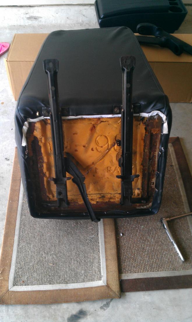

Drivers side seat with tracks installed.
attachment.php
Passenger seat with stationary brackets installed.
attachment.php

Stroked, the rear of the bench tracks have a v shaped bracket riveted to the back and the factory buckets tracks have a flat bar riveted to the back but the seat track itself is the same. The passenger seat is stationary but can be moded to be a slider with another set of brackets.
Except the buckets have a front bracket that bolts to the seat and bolts to the tracks, in between the two. That bracket only came with the rare pickup buckets. I was not aware of the pickup buckets having a front mounted slider knob (that could be adapted to the passenger side)... until I saw your pics.
attachment.php
attachment.php
attachment.php
attachment.php
attachment.php
Not shown here is the front brackets that must still be bolted to the driver seat. ^^^
In these pics of yours, those front brackets are visible...
attachment.php
attachment.php
attachment.php
attachment.php
attachment.php
Also, your seat brackets are completely different than mine (passenger side). My fronts are stamped a little different, but the rears stick out behind the seat, and bolt to the rear ledge of the cab. They are a pain to get at.

Yea Andy, these buckets came out of an 82 cab and chassis one ton (reg cab). The rear brackets use the seat belt bolts on both sides. Here are some of my mock up pics.
attachment.php
attachment.php
attachment.php
attachment.php

So this is the real OEM pick up truck seats the way it would have been done at the factory. :High 5:
J Knight
Sep 8, 2011
4,298
151
Baytown TX
82 Chevy
350ci
Yes sir, these seats are the real deal OEM from GM for reg cab squares.:)
35,208
43,896
That's a MUCH better design. The earlier setup puts the back of the seat right against the cab wall and it's flimsy enough you can grab the seat and wiggle it some.
J Knight
Sep 8, 2011
4,298
151
Baytown TX
82 Chevy
350ci
I wasnt expecting them to be that way, they were the first ones Ive seen that attatch at the seat belt and are very sturdy.
