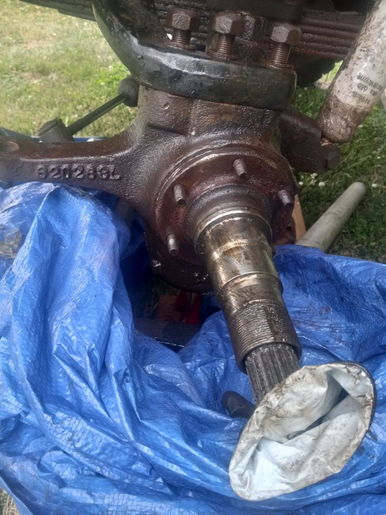

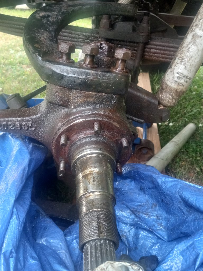

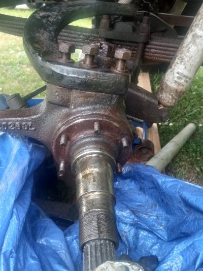

I need help I just bought a 86 scottsdale k20 and decided it needed ball joints and tie rods but I can't get spindle off??? I've heated it and beat the heck out of it now still not coming off?? It has gm 10 bolt axle.

Try putting a jack under the spindle with a piece of wood in between. A plastic dead blow hammer and keep beating on it. Heat should help.
If anything you can knock the studs out, that should help as well.

He hasn't made it to the ball joints yet I believe. Looks like he can't get the outer spindle off not the whole knuckle, to pull the axle shaft out.

I'm gonna try the air hammer tonight. I've soaked it in pb blaster for two days. And broke two old screwdrivers and a chisel. Myself an.d two friends beat the crap out of it for 4 hours last night it's starting to look deformed lol but still not breaking loose.

Sounds like you're gonna need a sledgehammer and a new spindle.. there's no secret bolts or anything, it's just the mounting nuts and a kind of tight fit. **** happens sometimes.
