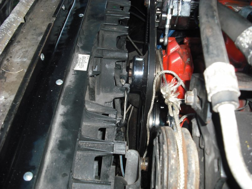

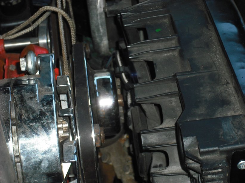

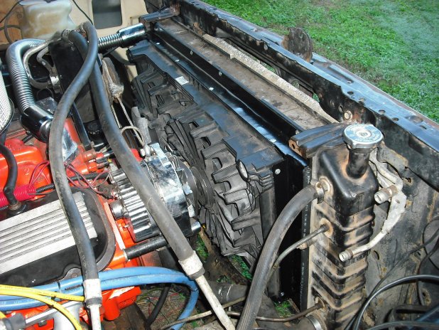

well I made a mounting adaptor to mount a Aztec hd cooling fans and shroud on my heavy duty diesel radiator made out of 18gauge sheet metal cut the top and bottom to 32in and bent to L brackets on the picnic table with a 2x4 clamped to it then cut the sides to 15 in and bent to L brackets mounted the fans to the rad and welded all 4 corners and put on the truck fits tight and moves some air . mow need to close off the top of the rad to the rad support

Pretty tight fit, looks good though.

Interesting..but whats the string for?

the string was used for pulley alignment and belt size
