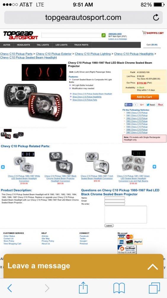

If anyone has how were they? Any good, and do they out out more light than/better light pattern than stock sealed beams?

Im planning on trying a set of these maybe or just the plain H4 lenses???

The halo lights are a separate 12 v circuit so you can wire them to a switch or a key-on ignition source for day lights or just for when you want to show them off.
