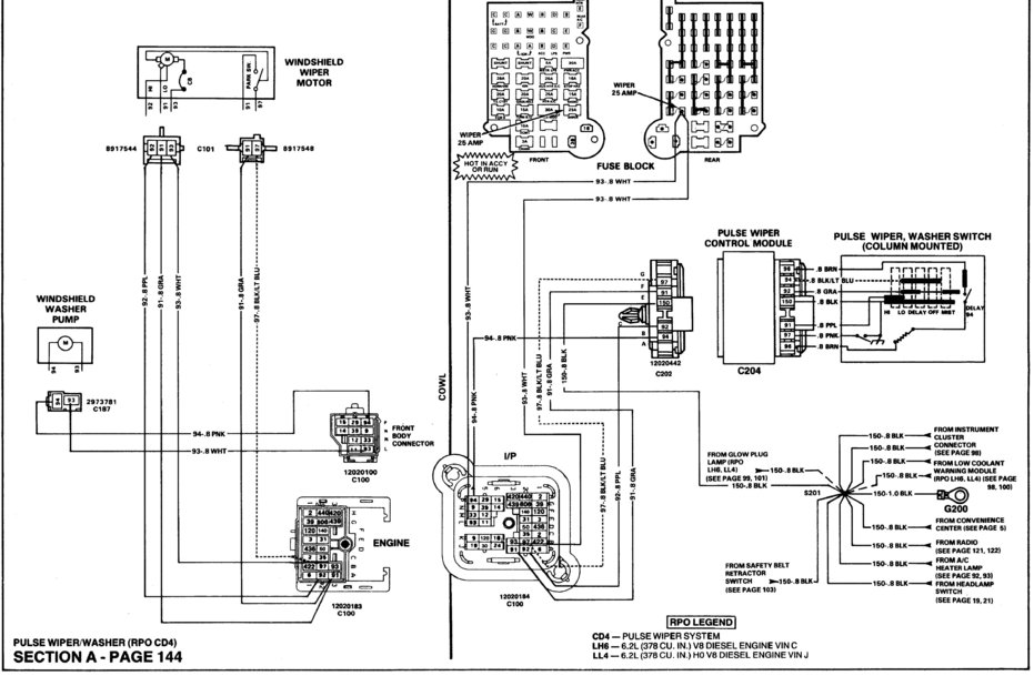

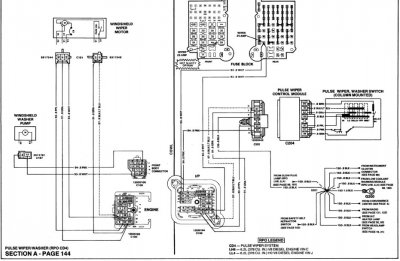

Unfortunately that diagram shows up too small to read on my end and when i blow it up its too blury to read could you tell me what i should be seeing where? Power where and gnd where

Maybe one of these will be more legible:

Well checked Powers checked grounds all okay even ran grounds directly from battery to where grounds should be no difference in speed and I know the linkages are good so I installed a new wiper motor today and it's about four times faster still not the fastest thing I've ever seen But usable and much much faster than it was
Thanks to all that gave responses and special thanks to chengny for the wiring diagrams
