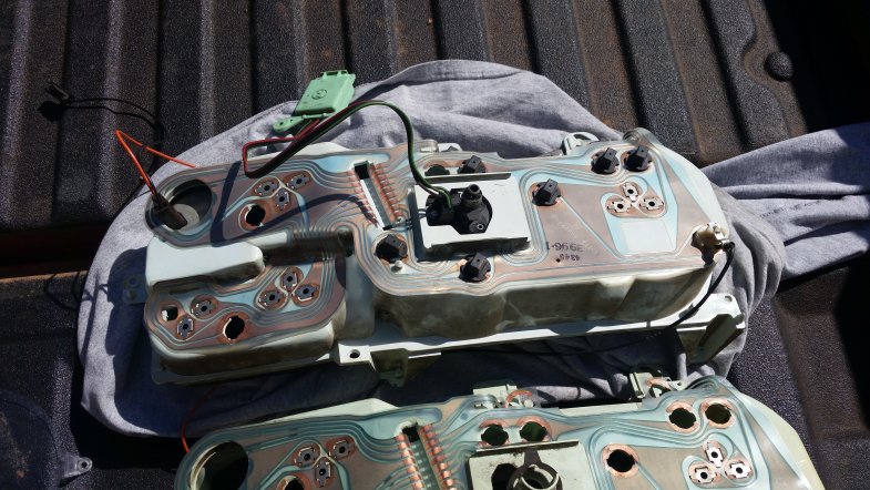

I am trying to get a truck ready for my daughter who turns 16 in July. I offered to buy her several different vehicles (a lot of the $$ is hers that she earned) but she insists she wants my daily driver truck. There are several things wrong with it that didn't bother me so much with me driving it but I want it correct for her.

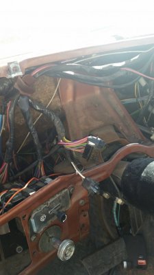

Since I bought the truck it's only had about 1 of the gauge lights working. Also, someone had installed some pod gauges and mounted them under the dash. I didn't like them and wanted the originals used.

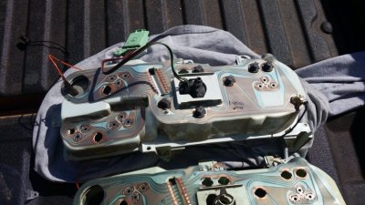

Once I took out the gauge cluster to install the bulbs, I noticed it had 3 of the ears that are mounts broken. I also noticed that green box for the cruise was missing. I bought a cluster off of Ebay and am now trying to install it. Here are the problems so far:
I plugged the gauge cluster in and the temp gauge goes all the way to the right (260 degrees) and stays there.

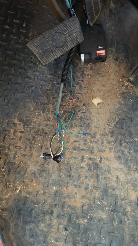

I don't know where to find the wire that would lead to the oil pressure gauge. I was hoping they just took it off and hooked up the one going to the aftermarket gauge but I am not seeing it.
I have no idea where the green cruise box things plugs in.

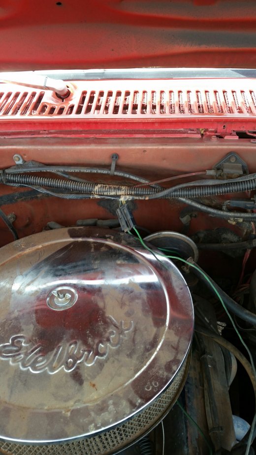

It does not appear that the wires to my plug were cut anywhere so I am assuming they ran new wires to run the gauge cluster. I found what I think should be the water temp wire with a black fitting on the end laying on my intake manifold. I put it on but got nothing. I think the black end that slides on the prong coming off the thermostat housing is bad but not sure.
Here are some pics but they suck. Was holding my phone wrong I guess.
The second pic is the one showing the wires the previous owner used to run the aftermarket gauges.

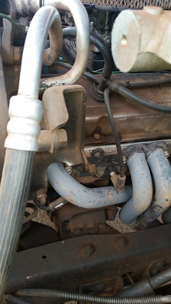

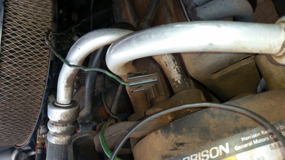

Looks like the connection on my sending unit is broken off.
Also, does this look like the wire that would go to the sending unit.

That looks the like the one! That clip should just slide onto a peg on the temp sender, the wire is green which looks like that's what you have

Thanks, I will have to get me a new temp sending unit and see if that does it.

In your first picture there is the main cluster connector and another light connector, what is that light connector for? Also my oil pressure gauge pegs out as soon as the engine starts and the wire I have connected to it has a rubber connector on it like you said your temp gauge has. So what is the correct wire for the oil pressure sensor.
It's hard for me to tell (I'm color blind). But if the leads into the socket are brown and white, that is most likely the socket for the 4WD indicating lamp.

It looks like brown and white wires from what I can tell.
I believe chengny has it correct when he said it was my 4WD indicator lamp, which reminded me I forgot to plug that back in before setting the cluster back into place.
I put a new temp sending unit in but still nothing. My black rectangle connector is partially melted in a spot and looks a little crushed. The green wire it's attached to runs along with the wire that goes to the ac compressor and then clips into another black clip near the center of the engine compartment along the firewall.

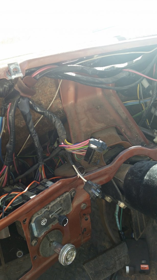

Here's a pic of the connection

Do you have the ground going to the firewall from the back of the head?

Just went out and checked. There's one on the passenger side firewall right behind the head. I just reached out and grabbed it and it's broken completely off.
Thank you very much, that fixed it. I didn't even hook up a proper ground, just took some alligator clips, put one end on the broken ground strap and the other on the alternator bracket and the gauge worked immediately. I will get a correct ground hooded up tomorrow.

Perfect! That ground can cause all sorts of weird electrical issues and is often overlooked or people don't even know about it.
