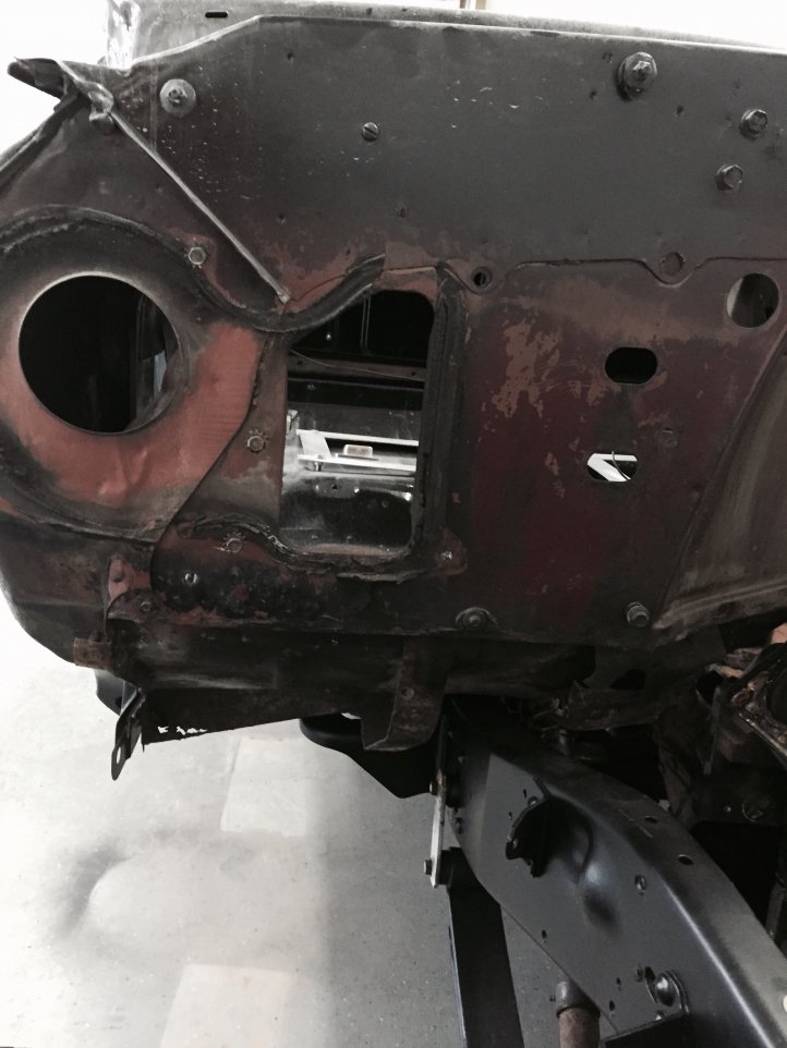

I have an 82 k10 that does not have factory a/c. I don't want the vintage air unit so that is out of the question. I've seen several pictures of the rectangle hole that needs to be cut out of the firewall but I have yet to find any actual dimensions. I do not have the evap or motor housing at this time or I would line it up and go from there.
So my question is, are there any measurements that you guys have so I can get the hole cut ?
I attached a picture of my firewall, let me know if it isn't viewable. Thanks

here's a picture of my AC firewall. it's open currently right now if you want any measurements. I don't see why it has to be so precise, within a quarter inch would do fine I would think. then you could fine tune it to fit the units you get.

here is the other firewall in my driveway. I think the evaporator housing would seal fine as long as you didn't cut the hole way too big.
