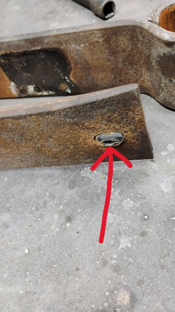

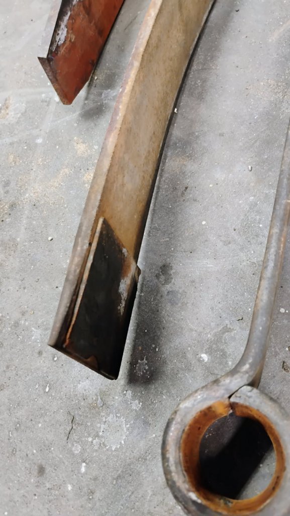

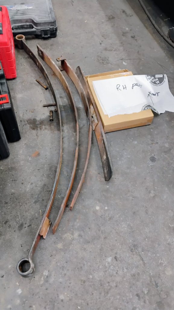

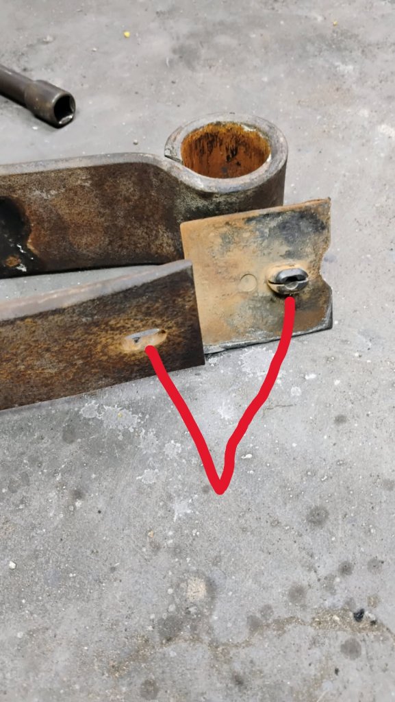

I posted a question a while back about these plastic shims but that was before I took my springs apart. Now I see there is a hole on each end of one of the leafs that had a plastic shim that snapped in place. The pass side had the little plastic nub broke off so the shim scooted away from the end, there is wear on the spring from them rubbing together. The drivers side doesn't have the wear since the plastic shim is still attached. This is on a 78 C10 Scottsdale that has never been took apart before, I've known the truck since new. Any ideas on where to get new shims like these? I've looked at LMC and every other place I know and found nothing. Without the nub they won't stay in place. May be fine without them but there is a little wear where the shim slipped off.

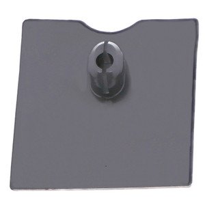

Well, I dug around more and found a site "General Spring". Search "leaf springs", then "leaf spring parts", then "tip inserts". They have round, square, and rectangle shims. They have one that looks exactly like mine with the same oval hole. A few other sites have them also but they are hard to find since you have to search specific names such as Button Slider, Leaf Spring Tip Insert, Squeak Pads.

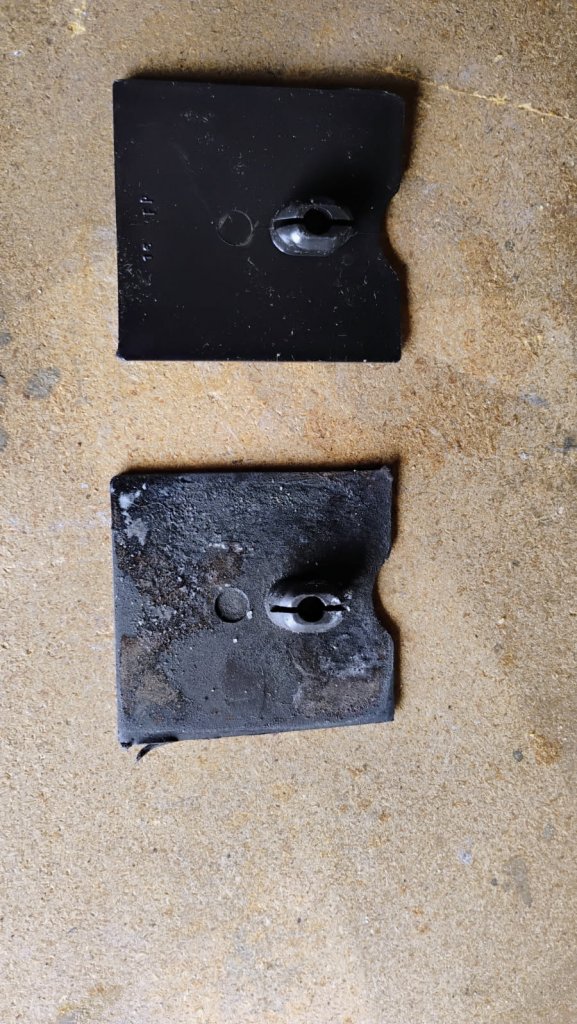

I dont have a ready picture of the hole they stick in , but heres a blurry picture of the gmt800 ones on my 2500hd

Shop around by pn I used the pn D-58 from KC Spring (not sure d-58 is what you need, just used it as an example)
And found them alot cheaper here
I have ordered from both places before
I got from General Spring: 2.99Ea
2 × 2-1/2" Wide, Square Leaf Spring Tip Insert with Offset Oval Button​
