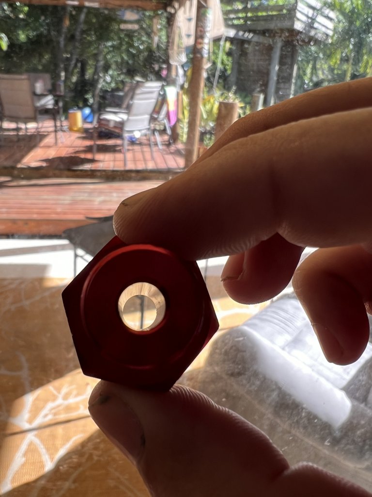

Replacing carb on my 454 83 k5
I bought some braided line and am re-plumbing my fuel supply along with a new carb.
I have holly electric pump going to a nice big fuel filter mounted on the inner fender going to a pressure regulator then to a Russel duel feed. I got shiny braided line because pretty stuff makes the truck go faster.
I have a bunch of connections including several 3/8 NPT to 8AN male/male connectors I got from China by way of Amazon. And I think the ChiComs are trying to sabotage our engines by intentionally sending fittings that are internally restricted.
The 3/8 npt side has a much smaller internal diameter. I was thinking of drilling it out to open the passage. Aside from ruining the pretty red finish of the INSIDE of the fitting, is there a reason not to do this?
Take a look at the pictures

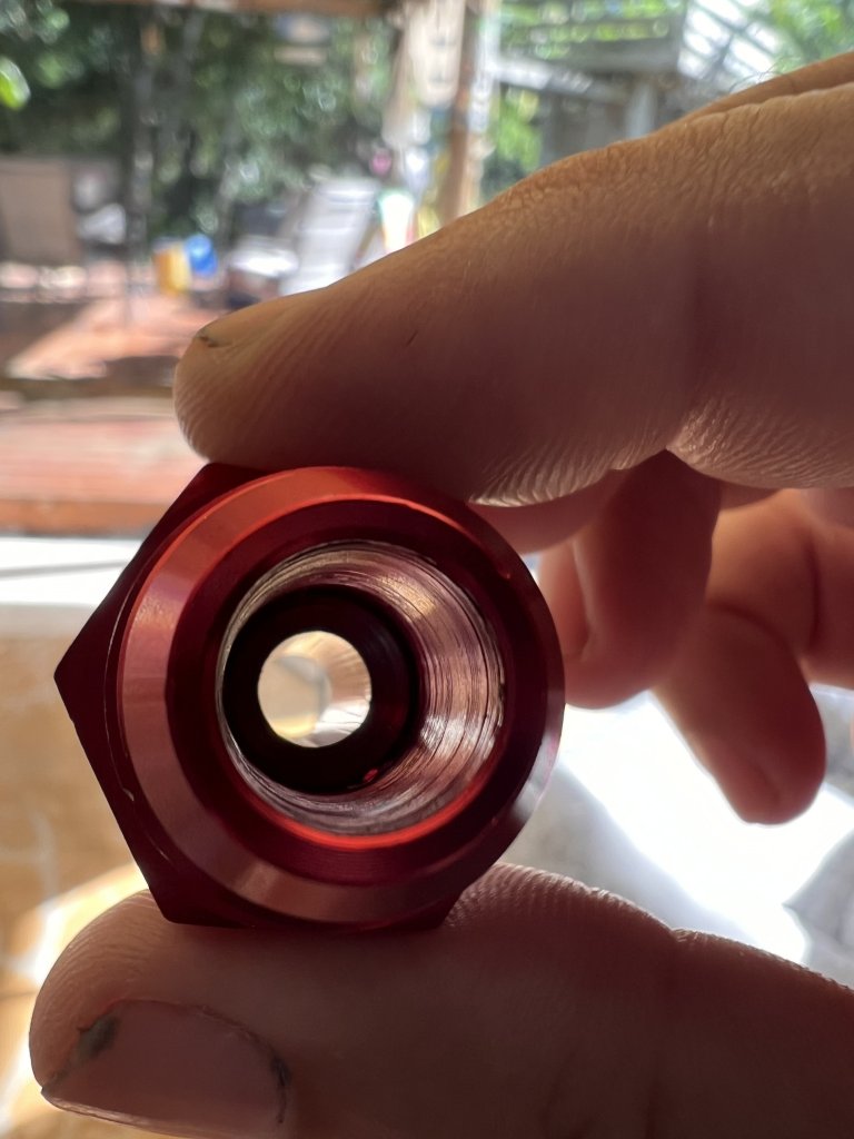

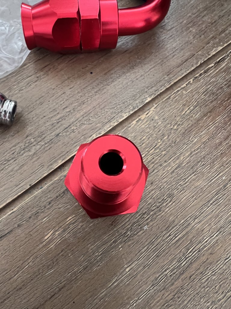

Thank you I don’t disagree and am not looking to meet firemen
The fittings I’m talking about are the NPT to male end adapters. It’s not the part that seals against the hose. Those I have from summit.
These are basically solid bits of aluminum. That look like the ID of the NPT side are much smaller than the AN side.
I guess I’m wondering if they are supposed to be like this or they did not finish machining them when they make them.
The npt side is screwed inside the fuel filter and the flared AN side is what the AN fitting screw onto
I suppose it could be like this for a reason but it looks like it will restrict the flow. I don’t have any experience with these and don’t know what’s normal

Do you need to drill it out? Is the smallest point more narrow that a factory steel line inside diameter.
It’s smaller than the braided line ID. It is also smaller than the 3/8 regular brass NPT nipple I compared it to. Probally 1/4”
Don’t know if I “need” to ie will it flow enough as is. It’s a 454 but not a crazy race engine with 950 dominator
Yea. Is it smaller than the inside if the factory steel line running from the tank to the front. Stick a drill bit in each to check size.
I’ll do that. my only real problem is going to be figuring out how to sleep at night knowing the inside of the fitting will be all scratched up
