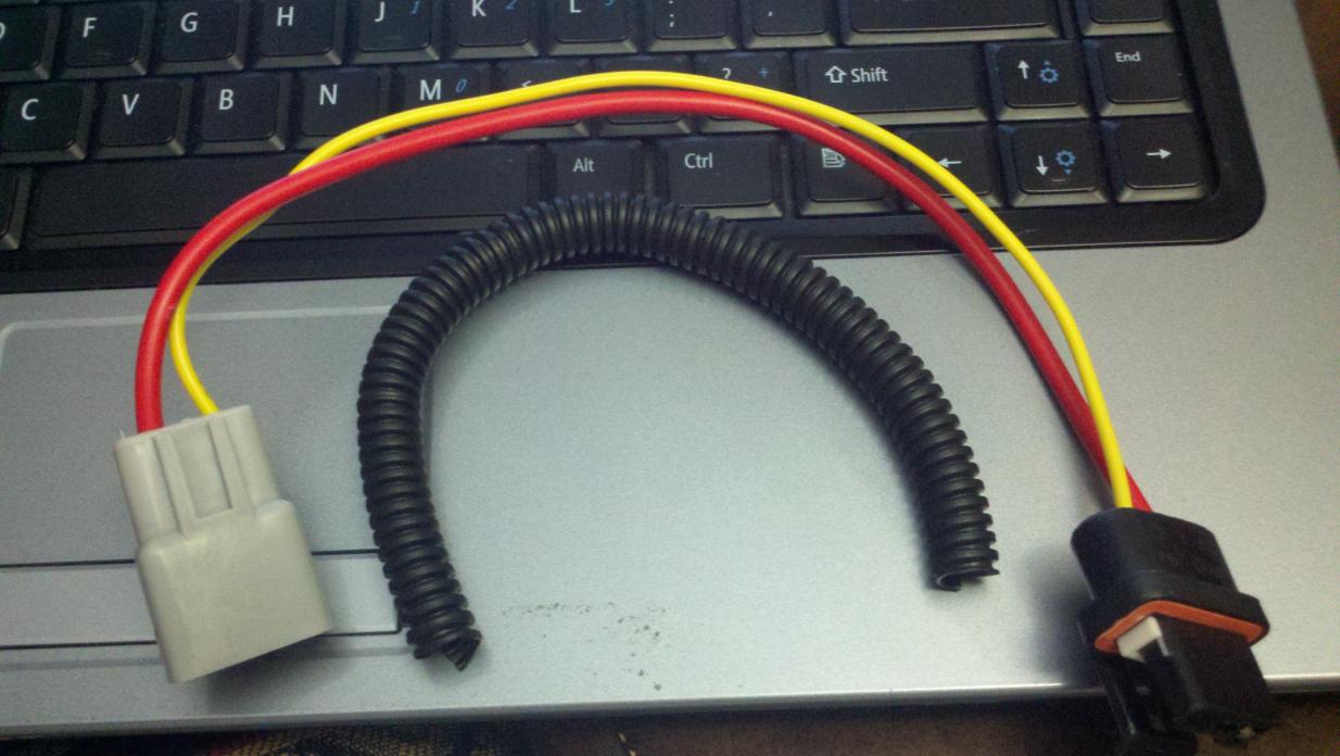

Well I got my adapter from Rock Auto and its not the correct one. The photo shows it to have the resister. They sent the same part number but a connector without a resister.
I'd just try it and see if it works. Worst case, it just wouldn't charge... but I'm curious to see if it would work. I think it will.

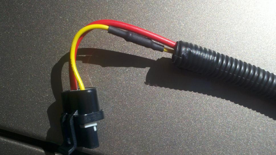

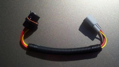

Well I finally got the right plug in the mail today. It has the resister built in.
