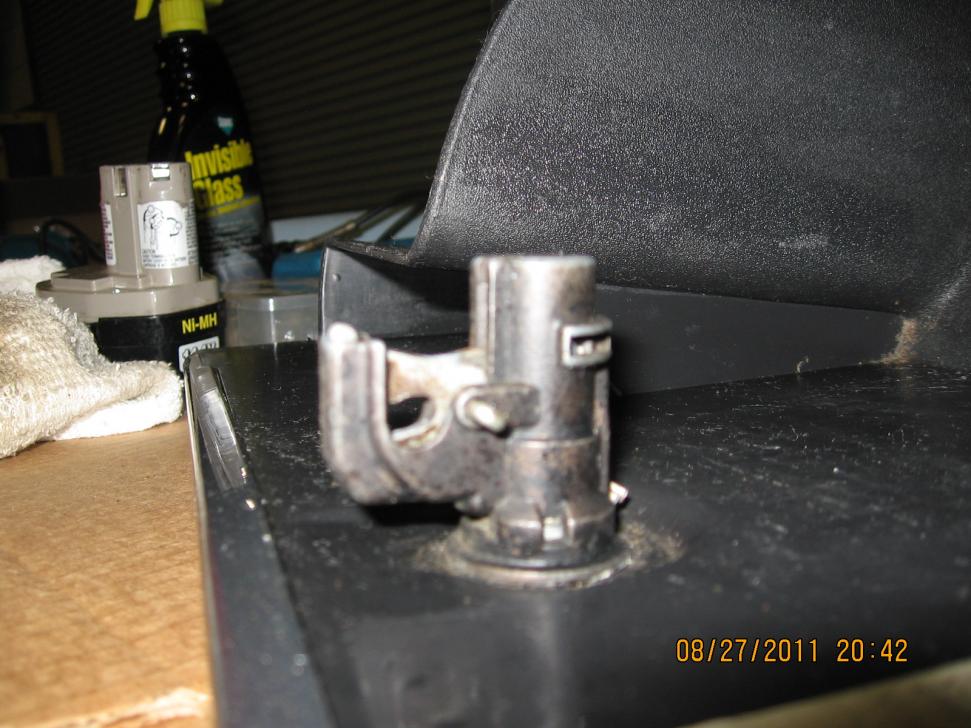

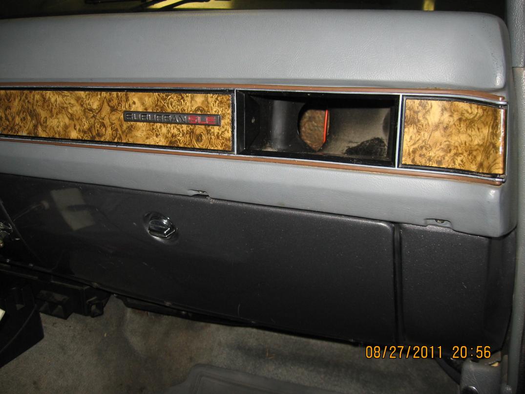

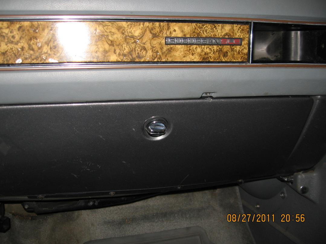

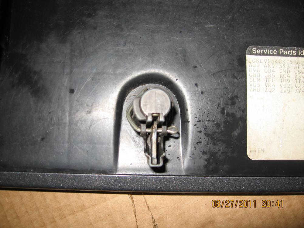

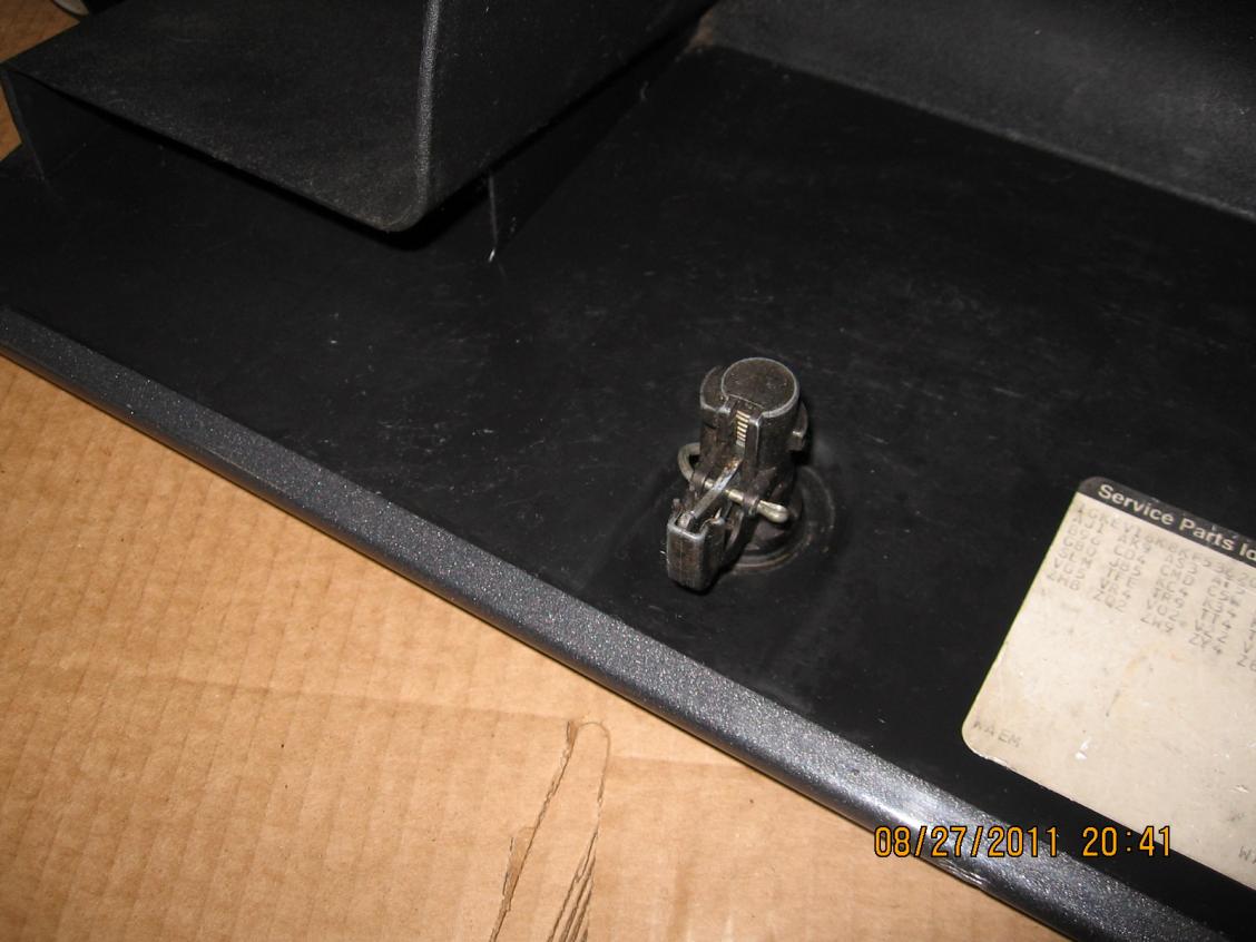

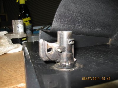

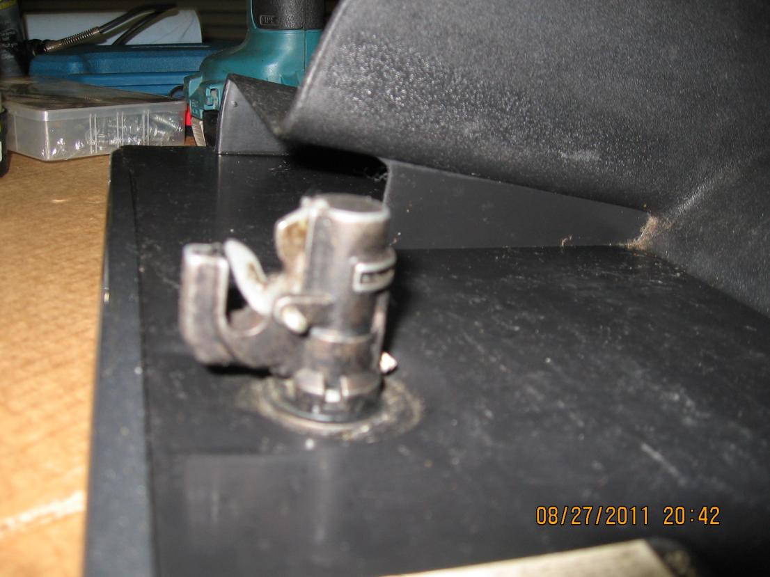

I was able to fix the glove box, here a pin fell out for the latch. I just used a cotter pin and stuck it in there. Works fine now, fuggit...

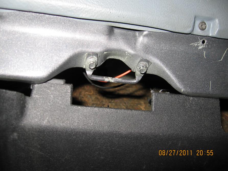

I also had to adjust the striker out a little to make it shut nice without slamming it, it is adjustable.
