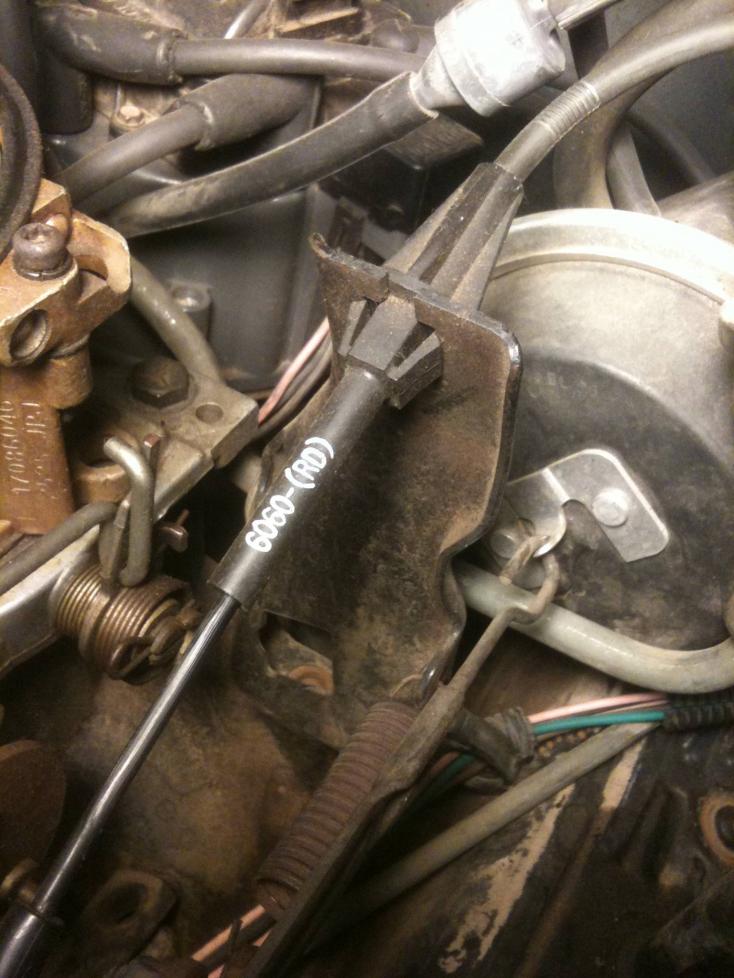

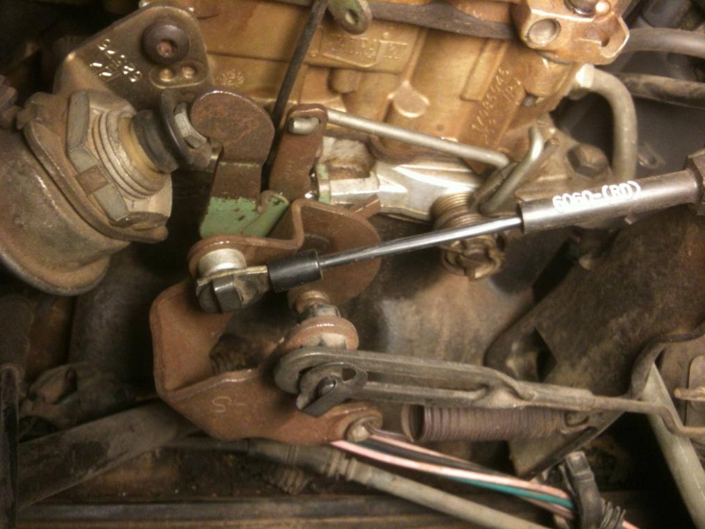

You need the right bracketry to keep the kickdown adjusted right. If it isn't right, you will burn out the trans in short order. You truck MAY have the correct throttle if the carb is original and you might even have the right brackets already, I have seen some V6 trucks with it.

Took some quick pics of the brackets on truck now, carb is stock qjet as far as I know..
