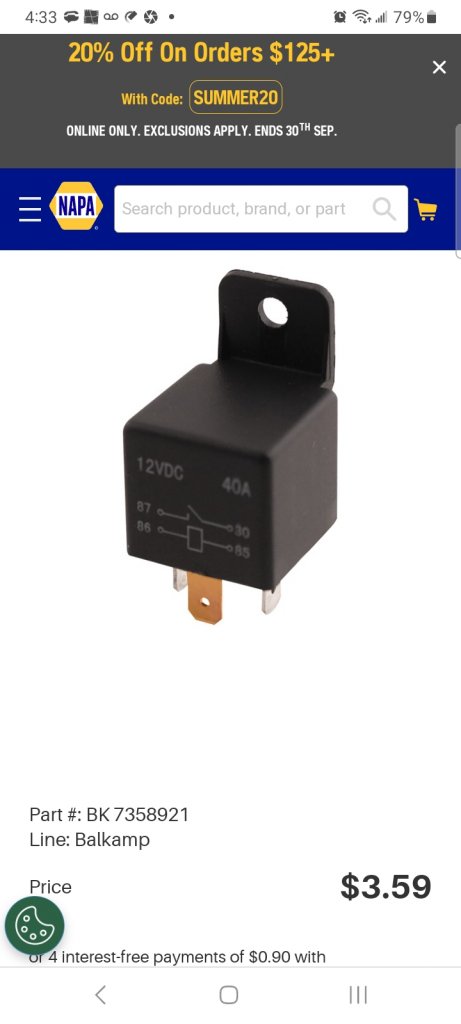

Okay easy peasy. Way get a generic 4or 5 wire relay and socket from ebay,parts store where ever hook terminal 30 to battery 12v+ hook terminal 87 to your new lights 86 to battery/chassis ground. Hook terminal 85 to a marker light hot lead. Whenever the marker is on current will flow from 30 to 87 turning on your aux lights. I'll get you a relay pic and part number in a minute. You don't actually need a relay socket wires and 1/4 female terminals work. Fuse terminal 30 with a 15 amp fuse again 1/4 female terminals will work as fuse connections. Brb.

Okay easy peasy. Way get a generic 4or 5 wire relay and socket from ebay,parts store where ever hook terminal 30 to battery 12v+ terminal 87 out to your new lights 86 to battery/chassis ground terminal 85 to a marker light hot lead. Whenever the marker is on current will flow fro 30 to 87 turning on your aux lights. I'll get you a relay pic and part number in a minute. You don't actually need a relay socket wires and 1/4 female terminals work. Fuse terminal 30 with a 15 amp fuse again 1/4 female terminals will work as fuse connections. Brb.
yes using original/old wiring on the vehicle to control relays makes it easy.
