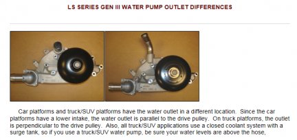

Hey boys,
Has anyone come up with an adaptor to change the outlet on the LQ4 water pump so it discharges in a forward style similar to the LS3/L99 water pump?
I wanted to do the 2010 Camaro water pump mod but by the time you purchase the pump/tensioner/adaptor/pulley etc, it's a damn pricey swap.
