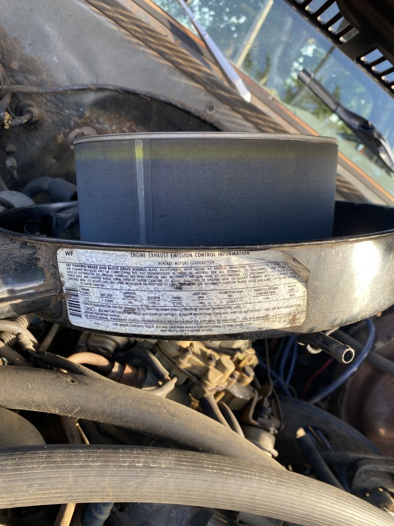

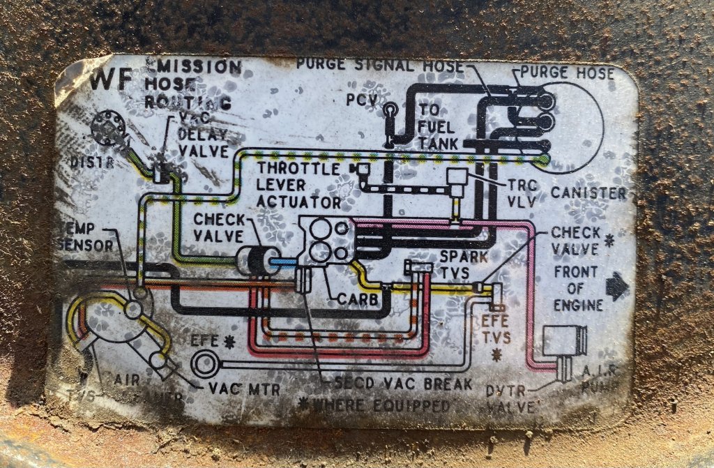

It depends on whether yours is federal emissions or Cali emissions. A 1980 8600GVW truck means it was over the light truck weight limit for emissions, therefore it did not require a cat or EGR. It may or may not have a charcoal canister. It could also be a canada truck, in which case it would also have a Cat like @Catbox truck.
These are the stickers on the air filter housing. Looks to be the heavy duty so not cat and egr.
Also my vin indicates my truck was from Fremont, Ca (the Z)
TCM24AZ500267

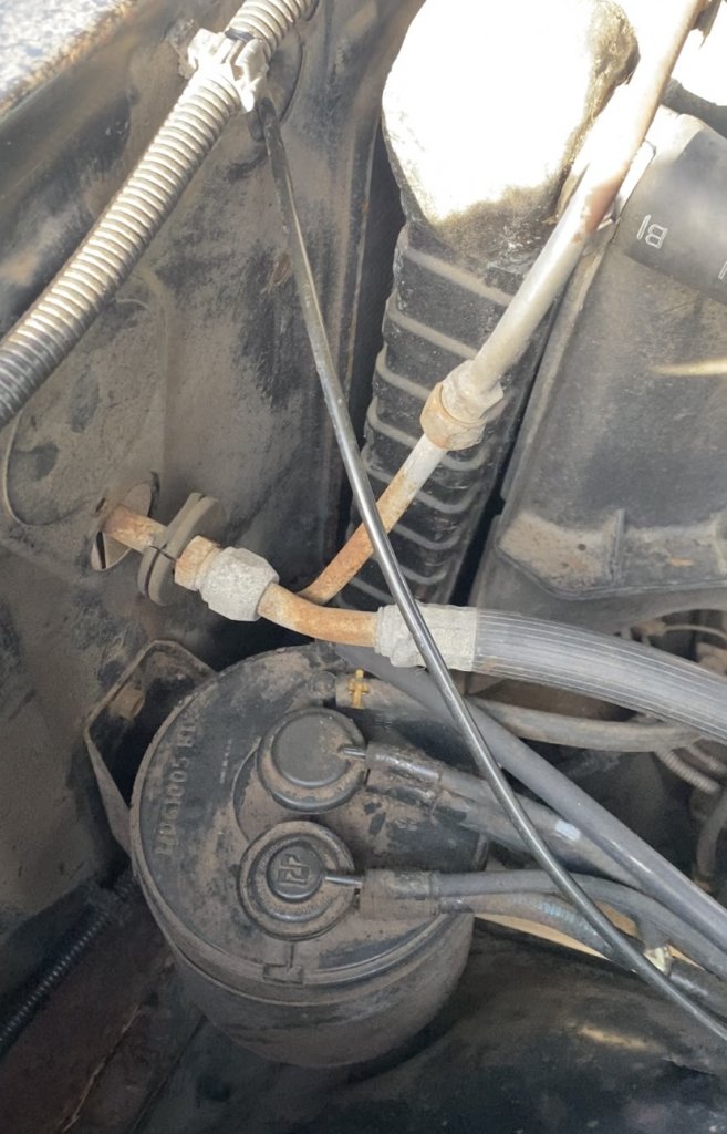

Does appear to have the charcoal canister. That’s what this is right? Do I just keep all this emissions related stuff? So many things and hoses involved lol!

The middle picture is your emissions tag on the air cleaner. At the very bottom of the tag it says "This vehicle conforms to all EPA and CALIFORNIA regulations applicable to 1980 model year". That means you have California emissions, so the truck was likely originally sold in California(A vehicle can be built at the Fremont plant and not have been sold in Cali). I think that a normal K20 would have a pellet cat, but the 8600GVW might have exempted it in Cali too and that is also why you have the AIR pump. If you look at the california catalytic converter application listing, they don't have any listed for 1980 C/K 30, likely because of the higher GVW.
Yes that is the charcoal canister. All of my stuff is missing, but I hacked together a vent system through a "canister" because I hate the gas smell ever time I walk past the truck in the summer :)
